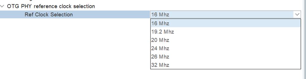

I'm trying to work with USB on STM32U595ZJT6Q (with SMPS)
Ref Clock Selection under USB_OTG_HS is set to 16MHz
OTS HS Clock Mux is set to HSE (the board has 16MHz crystal)
CubeMX 6.11
STM32Cube_FW_U5_V1.5.0
The code is stuck in USB_CoreReset, more specifically it waits for USB_OTG_GRSTCTL_CSRST to become 0

‎2024-04-13 1:55 PM
Okay, I think I figured it out. SYSCLK has to be more than 48MHz. Just changing it to 64 MHz fixed an issue.

There is an HAL_PWREx_EnableVddUSB() call that is executed (line 40).
Also tried 24MHz and 32MHz by using the PLL(16MHz was from HSE). Maybe it's a good option to physically change the crystal for a 24/32MHz one?
No, this is just the reference clock, you set in clock tree , what you want; it should be no difference, what crystal is used. I always prefer a standard frequency here, 8 or 16 M .
