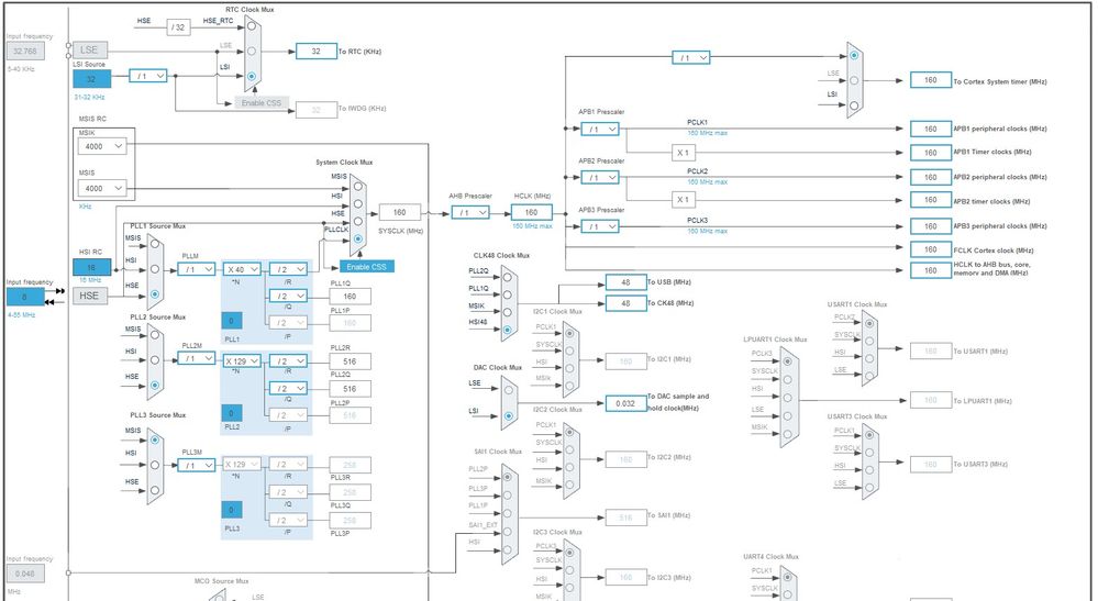

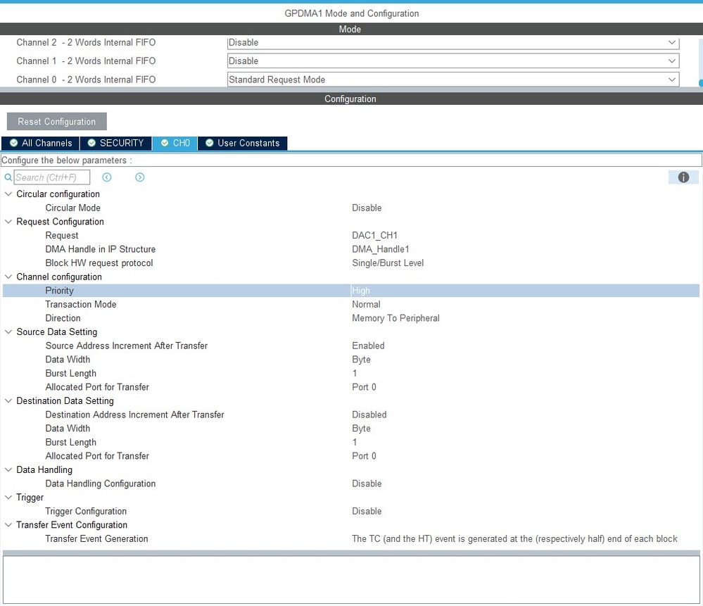

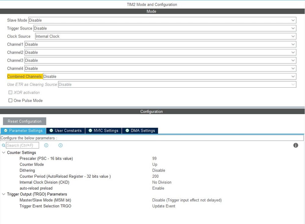

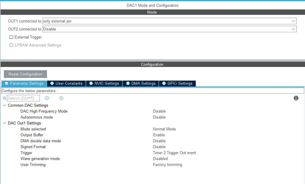

Here's the challenge; the chip fails immediately with a DMA_FLAG_DTE error, with the trigger overrun flag being set in the CSR.  No idea why or where to go next after 2 days of trying to troubleshoot this.  Here is the MXCube configuration:
