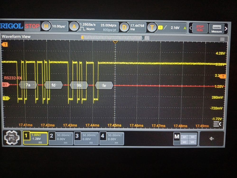

  • Data Source: A peripheral sends packets of variable size (approx. 2048 - 4096 bytes) at 1,000,000 bits/s.
  • Idle Time: There is a guaranteed idle time of > 45ms between packets. This should be more than enough to trigger the UART IDLE event.

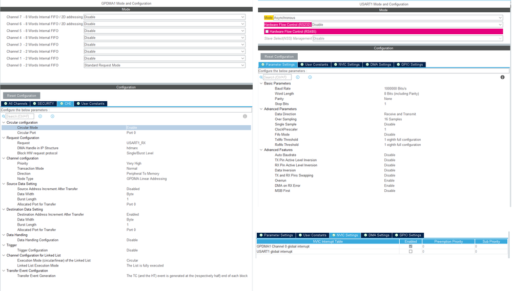

Here is the .ioc
Here is the RX line on the scope:

  • Changing GPDMA peripheral and channel: No change.
  • Enabling/Disabling NVIC on the USART1: Enabling it (with or without UART_CheckIdleState) stops all UART interrupts (if the DMA is active, if i turn the DMA off it works normally). Disabling it gives the behavior described above.
  • Disabling Overrun on UART settings in CubeMX: No change.
  • Disabling Circular Mode on GPDMA config in CubeMX: No change, except the DMA stops after the first 1000 bytes (as expected).
  • Handling the interruptions and init directly on main.c: No change.
  • Disabling HT and TC: No change.
I appreciate any tip or advice, I don't think the problem is with my custom board as everything else, I2S, USB, HSE, works without a problem.

Guenael Cadier
Hello @mipi
In order to have HAL_UARTEx_ReceiveToIdle_DMA() working as expected, it is mandatory to have USART1 IRQ enabled : IDLE event will be detected using IDLE interrupt at UART level.
If you enable it using MX, USART1_IRQn should be enabled durint HAL_UART_Init() call so prior any communications.
Now, if you mentioned "Enabling it stops all UART interrupts", I think it is the part that needs to be investigated.
What do you mean ? no reception at all ?
Could you check content of USART1_ISR when it occurs ? (to check if OverRun error flag is raised).
Regards
