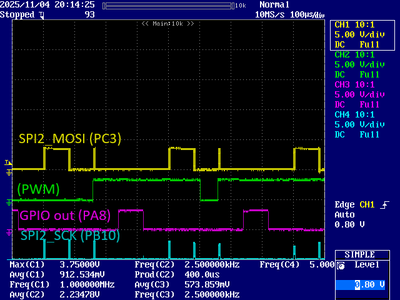

I am using the Nucleo U575ZI-Q board. I need to use GPDMA synchronized with a timer to set multiple GPIO pins synchronously, perform SPI transmission, and configure PWM periods.
I have found a working combination: software request + trigger TRGO. However, TRGO is only available for TIM15 and TIM2, which limits its versatility. Ideally, I would like to use hardware requests (such as REQUEST_TIM15_UP).
Set TIM15 to output TRGO. Configure GPDMA1_CHANNEL7 with LinkedList for DMA_REQUEST_SW and set the trigger to GPDMA1_TRIGGER_TIM15_TRGO. The direction should be set to Memory-to-Memory. Specify the source as memory and the destination as GPIOA->BSRR or SPI2->TXDR. This will allow you to generate the waveform shown in the attached oscilloscope.

HAL_TIM_PWM_Start(&htim15, TIM_CHANNEL_1);
HAL_TIM_PWM_Start(&htim15, TIM_CHANNEL_2);
SPI2->CR1 |= SPI_CR1_SPE;
SPI2->CR1 |= SPI_CR1_CSTART;
MX_TimingSPI_GPIO_O_I_Config();
HAL_DMAEx_List_LinkQ(&handle_GPDMA1_Channel7, &TimingSPI_GPIO_O_I);
HAL_DMAEx_List_Start(&handle_GPDMA1_Channel7);

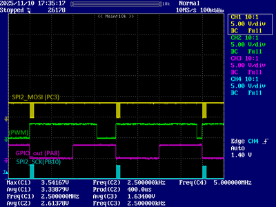

Hello DHIF Khaled,
The effect of __HAL_TIM_ENABLE_DMA(&htim15, TIM_DMA_UPDATE); was dramatic! I was able to execute the intended process. For synchronizing with TIM15, I used GPDMA1_REQUEST_TIM15_UP only for the first instance, and for the remaining nodes, I used DMA_REQUEST_SW, which allowed the DMA to execute all at once (though I'm not sure if this is the correct usage).
TIM15 executes at twice the frequency compared to other TIMs for PWM waveform generation, and it is used for 96-bit SPI input/output and for switching the PWM duty of other TIMs.

Hello DHIF Khaled,
