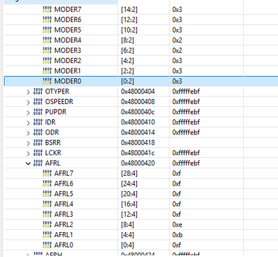

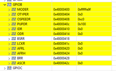

The GPIO is configured as such, looking at the registers:

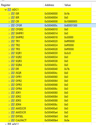

And the ADC (DR is 7B/123 because right now the triggers are slow):

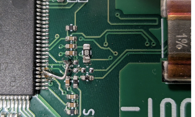

I have just made a board patch using tiny little wires between the opamp output and the ADC input on a different pin (PA5, ADC1 in10).
It works instantly. With this setup, the OPAMP channel also responds a bit (I set injected conversions to measure bothPA5in10 and PB0in15) but the PB0 response is about 1/3 of the response from the PA5 pin.
I think there must be some error in the ST HAL/CubeIDE configuration mechanism (or a silicon bug?) that prevents the ADC from reading the opamp when configured with the pin in dual mode.
Modifiet board that successfully reads current on PA5

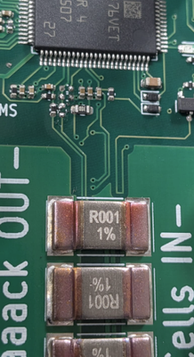

Un modified board fresh from factory

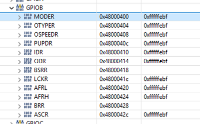

waclawek.jan
The GPIOB registers you've shown indicate, that you don't have GPIOB clock enabled in RCC.
I don't know whether this is the cause of your problems. I don't use Cube/CubeMX.

I just added
  GPIOB->ASCR |=0x01;
after the opamp start and before the ADC start and it works perfectly.
