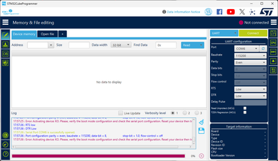

I've tried many times with different times between resetting my target and trying to connect with the programmer, but no success. I hope a capture of the serial port will help diagnose the problem, so I've attached both an ASCII view of a failed attempt and its hex view (from the same connection attempt).
Please take a look at the yellow-highlighted areas in both images. A 0x7F is sent, and the response is 0x7F 0x1B, followed by another 0x7F being sent. The programmer's log shows:

The Programmer window look like this:
Not sure what all the other extraneous junk is in the terminal window.
Just use something simple like Real Term in HEX mode to send a simple 0x7F pattern. Don't use STM32 Cube Programmer. You're just trying to test the challenge response sequences.
You need to use EVEN PARITY.
Like I said the 0x7F should yield an 0x79 response if working properly.
