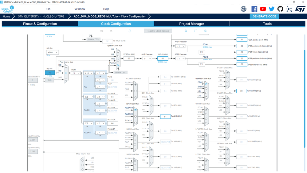

I have two input channels which I have to sample simultaneously so I wanted to know what should be the ioc setting for the same? and what HAL commands are used to run ADCs in this mode?

‎2023-06-06 8:05 AM - edited ‎2023-11-20 4:02 AM
Hello @AKhot.1​,
You can get started with this example STM32CubeL4/main.c at master · STMicroelectronics/STM32CubeL4 · GitHub
Also, if you set ADC prescaler asynchronous clock, you are using these options.
Otherwise, if you set synchronous ADC prescaler, it should be greyed out.
Hope this helps!
