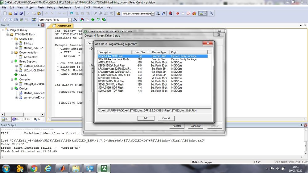

I bought a STM32L476 board. I started with the demo available in keil uVision and it worked fine easily, but it is closed, you cannot modify anything.
My question is: may I follow the MOOC with this board? instructions require a different specific board ¿!?
and/or : is there any other starting point to learn with this board? my previous experience is with launchpad TIVA TM4C123G, as well as very bad experience with freescale boards (I was unable to execute anything with them using Keil uVision, which is my prefered development system)

Which board? Which MOOC? In which demo you can't modify anything?
MFaun.1
board : STM32L476 as explained before (reference nucleo-L476RG displayed on the bottom of the package)
MOOC: any MOOC available in ST website, all of them declare the same model is required STM32F401RE MCU (ref: NUCLEO-F401REhttps://www.st.com/content/st_com/en/support/learning/stm32-education/stm32-moocs.html
demo: as described before the Keil uVision one (there are only 2, I started with the first one): https://www.keil.com/boards2/stmicroelectronics/nucleo_l476rg/ from software pack (see the yelow key on the C code below, which means you can't modify anything)
