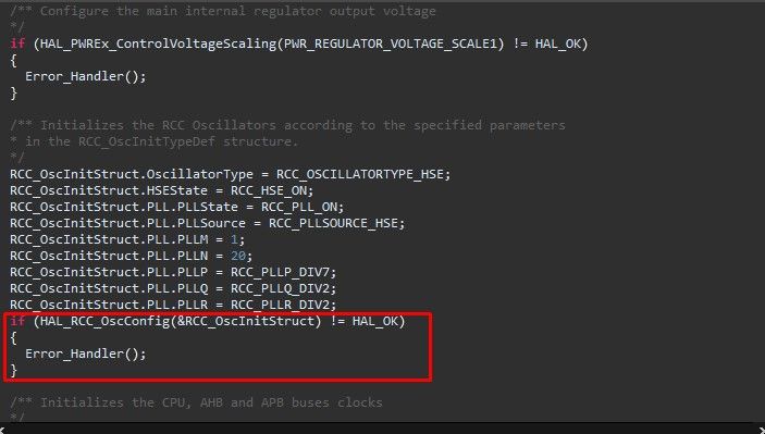

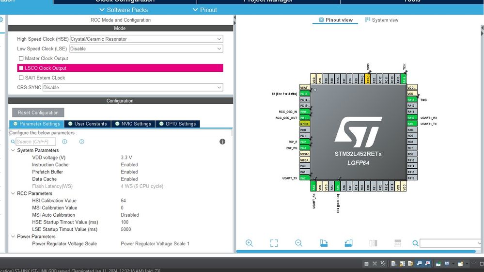

I am attempting to send AT commands via USART1 to an ESP8266-01 connected to my STM32L452RE Nucleo board. I am trying to initialize an HSE with the following settings:

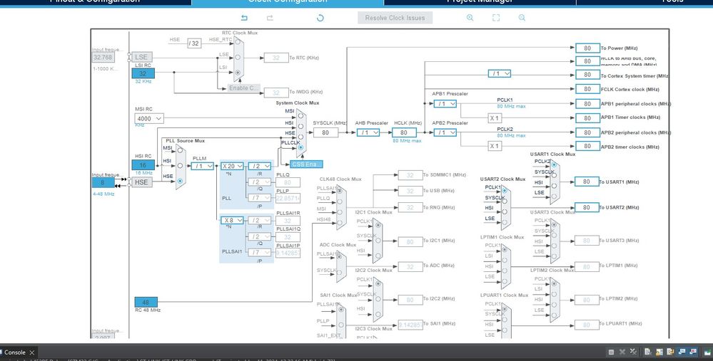

And the following clock configuration:
My problem is that the code is stopping in the  SystemClock_Config() function call in main.c, specifically here:

AFAIK, on Nucleo-64 boards with STM32L series MCUs, by default there is no connection to HSE, so HSE cannot work at all.
You have 3 options:
1. Use MSI - its accurate enough for UART communication.
2. Use MSI synchronized to LSE (LSE scillator is usually present on STM32L4 boards.
3. Change the board configuration by resoldering the bridges, so that 8 MHz clock is routed from ST-Link to the MCU.
