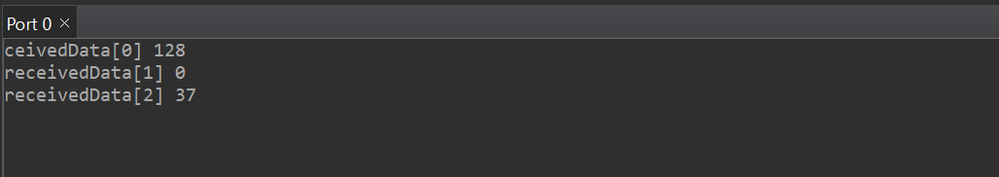

I'm using an STM32L452RE MCU to communicate with the L6470 stepper motor driver via SPI, and I'm currently having trouble reading data from the driver.
I’m able to transmit data (e.g., RUN, MOVE, SOFT_STOP commands).
  • The motor runs and responds correctly, so SPI transmit appears functional.
    Problem:
  • I'm trying to read registers like ABS_POS, ACC, etc. using the GET_PARAM command.
  • I always receive 0 in response, regardless of the register.
    Setup:
  • MCU: STM32 (HAL SPI)
  • SPI Mode: CPOL = 1, CPHA = 1 (Mode 3)
  • Driver: L6470
  • Motor: Connected and moving
  • MISO, MOSI, SCK, CS connections confirmed

Have you looked at the SPI lines with an oscilloscope and/or analyser to see what's going on?
ACC register is 2 bytes. You're only reading 1. The default value is 0x08A, so the most significant byte is 0 which is what you're reading. All is as expected.
The receivedData[1] never gets populated because your loop only runs for index=0. However, even if it did run, it wouldn't do anything useful. Unclear what is intended here.
Send 0x25. Read two bytes. That's your ACC value (MSB first).
Edit: Also, since you need to send 0 when reading values, you should use HAL_SPI_TransmitReceive here with 0s in the transmit buffer. A single transaction of 3 bytes will work. HAL_SPI_Receive sends arbitrary data. No good.
Apologies, you were absolutely right — I was mistakenly reading only one byte and not using HAL_SPI_TransmitReceive properly. I've corrected the code to send the command 0x25 followed by two dummy bytes (0x00, 0x00) in a single transaction to read the ACC register.
However, now I’m facing a new issue: no matter what value I set for ACC, when I read it back, I always get 0x80 0x00 0x89 (i.e., 128 0 137). I double-checked the write sequence as well and it appears to complete successfully.(I am able to execute run command)image.png
I’ve also attached the image and my updated code for reference. Any suggestions on what I might be missing?
Additionally, I’ve already set all KVALs and MAX_SPEED to their maximum values, yet the motor won't go beyond ~1000 steps/sec. Beyond that, it starts vibrating heavily and doesn’t rotate at all, I am using NEMA 17 and NEMA 23 with 24v Supply and tried with no load condition and with some load as well. Phase resistance for NEMA 17 is 3.3R and NEMA 23 has 2.23R
I've attached an image and included my updated code for reference. Any suggestions on what I might be missing would be greatly appreciated.
Thanks again for your help and patience!
