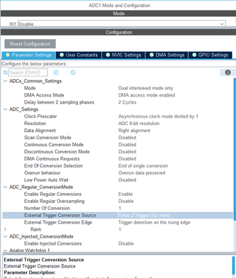

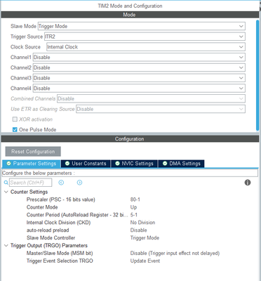

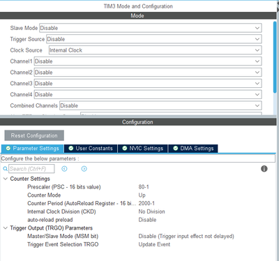

Hi, I am using STM32L476 Nucleo board to generate and read some signals. I am using TIM3 to trigger TIM1 and generate pwm signals. I also used ADC in interleaved continious mode and everything worked out. What I want to do is that I want the ADC and pwm signals to start together and only take 1200 samples(Or sample for a known amount of time) then transmit this data over UART. I tried to trigger ADC from TIM1 using OCREF1 but it breaks the pwm generation part. I tried to add TIM2 and trigger it wit TIM3, then trigger ADC from TIM2. And in ADC callback I added a UART transmit line(Used with continious mode before) but It is not sending anything. What could be the problem or how can I do this in another way. ADC is using MultiDMA for interleave mode. The 2MHz pwm signal is sent every 20ms and after I sample the first 1200 data(Or first 70us lets say), I will use the remaining time to transmit the sampled data.
Clipped Version of the Code:
static uint32_t adcBuf[ADC_BUF_SIZE];
static volatile uint32_t adcFlag = 0;
int16_t offset = 0;
int16_t adc1_v;
int16_t adc2_v;
HAL_TIM_Base_Start(&htim3);
  HAL_ADCEx_Calibration_Start(&hadc1,ADC_SINGLE_ENDED);
  HAL_ADCEx_Calibration_Start(&hadc2,ADC_SINGLE_ENDED);
  HAL_TIM_OnePulse_Start(&htim2, TIM_CHANNEL_1);
  HAL_TIM_OnePulse_Start(&htim1, TIM_CHANNEL_1);
  	  LL_ADC_SetMultiDMATransfer(ADC123_COMMON,LL_ADC_MULTI_REG_DMA_LIMIT_RES12_10B);
  HAL_ADCEx_MultiModeStart_DMA(&hadc1,adcBuf,ADC_BUF_SIZE);
  __HAL_DMA_DISABLE_IT(&hdma_adc1,DMA_IT_HT);
void HAL_ADC_ConvCpltCallback(ADC_HandleTypeDef *AdcHandle)
  for(uint32_t i=0;i<ADC_BUF_SIZE;i++)
  			  adc1_v= (((int16_t)(adcBuf[i]&0x0000FFFF)))*3300/255; // Extract ADC1 data
  				// from 32bit buffer then convert to milivolts.
  			  adc2_v= ((((int16_t)(adcBuf[i]>>16)))*3300/255); //Same for ADC2
  			  printf("%d\r\n",adc1_v);  //Send ADC1
  			  printf("%d\r\n",adc2_v);         //Send ADC2
  	    HAL_Delay(1);
  	    adcFlag = RESET;
void HAL_UART_TxCpltCallback(UART_HandleTypeDef *huart)

  MX_TIM2_Init();
  /* USER CODE BEGIN 2 */
  // Initialize TIM3 as trigger generator

  * @brief TIM2 Initialization Function
  * @PAram None
  * @retval None
static void MX_TIM2_Init(void)
  /* USER CODE BEGIN TIM2_Init 0 */
  /* USER CODE END TIM2_Init 0 */
  TIM_ClockConfigTypeDef sClockSourceConfig = {0};
  TIM_SlaveConfigTypeDef sSlaveConfig = {0};
  TIM_MasterConfigTypeDef sMasterConfig = {0};
  /* USER CODE BEGIN TIM2_Init 1 */
  /* USER CODE END TIM2_Init 1 */
  htim2.Instance = TIM2;
  htim2.Init.Prescaler = 80-1;
  htim2.Init.CounterMode = TIM_COUNTERMODE_UP;
  htim2.Init.Period = 5-1;
  htim2.Init.ClockDivision = TIM_CLOCKDIVISION_DIV1;
  htim2.Init.AutoReloadPreload = TIM_AUTORELOAD_PRELOAD_DISABLE;
  if (HAL_TIM_Base_Init(&htim2) != HAL_OK)
    Error_Handler();
  sClockSourceConfig.ClockSource = TIM_CLOCKSOURCE_INTERNAL;
  if (HAL_TIM_ConfigClockSource(&htim2, &sClockSourceConfig) != HAL_OK)
    Error_Handler();
  if (HAL_TIM_OnePulse_Init(&htim2, TIM_OPMODE_SINGLE) != HAL_OK)
    Error_Handler();
  sSlaveConfig.SlaveMode = TIM_SLAVEMODE_TRIGGER;
  sSlaveConfig.InputTrigger = TIM_TS_ITR2;
  if (HAL_TIM_SlaveConfigSynchro(&htim2, &sSlaveConfig) != HAL_OK)
    Error_Handler();
  sMasterConfig.MasterOutputTrigger = TIM_TRGO_UPDATE;
  sMasterConfig.MasterSlaveMode = TIM_MASTERSLAVEMODE_DISABLE;
  if (HAL_TIMEx_MasterConfigSynchronization(&htim2, &sMasterConfig) != HAL_OK)
    Error_Handler();
  /* USER CODE BEGIN TIM2_Init 2 */
  /* USER CODE END TIM2_Init 2 */
  * @brief TIM3 Initialization Function
  * @PAram None
  * @retval None
static void MX_TIM3_Init(void)
  /* USER CODE BEGIN TIM3_Init 0 */
  /* USER CODE END TIM3_Init 0 */
  /* USER CODE BEGIN TIM3_Init 1 */
  /* USER CODE END TIM3_Init 1 */
  htim3.Instance = TIM3;
  htim3.Init.Prescaler = 80-1;
  htim3.Init.CounterMode = TIM_COUNTERMODE_UP;
  htim3.Init.Period = 2000-1;
  htim3.Init.ClockDivision = TIM_CLOCKDIVISION_DIV1;
  htim3.Init.AutoReloadPreload = TIM_AUTORELOAD_PRELOAD_DISABLE;
  if (HAL_TIM_Base_Init(&htim3) != HAL_OK)
    Error_Handler();
  if (HAL_TIM_ConfigClockSource(&htim3, &sClockSourceConfig) != HAL_OK)
    Error_Handler();
  if (HAL_TIMEx_MasterConfigSynchronization(&htim3, &sMasterConfig) != HAL_OK)
    Error_Handler();
  /* USER CODE BEGIN TIM3_Init 2 */
  /* USER CODE END TIM3_Init 2 */

Stm325
Also I found out that ADC is not getting triggered by TIM2 right now, do I need to use "HAL_ADCEx_MultiModeStart_DMA(&hadc1,adcBuf,ADC_BUF_SIZE);" if I am triggering the adc with a timer. Because this is a single line in main and I can see that ADC is only working once
