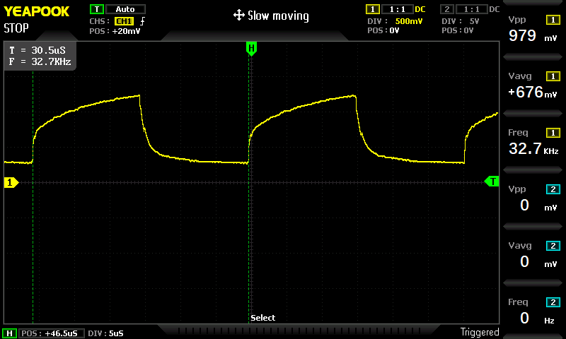

I looked at the clock going into the RCC_OSC_In pin (3), and saw a 32.768 pulse. There only looked to be around 1v peak height. What sort of amplitude should it be?

Turns out that the wrong clock chip had been fitted - they'd used the low-power variant, so the swing on the clock signal was not sufficient for the processor to detect.
