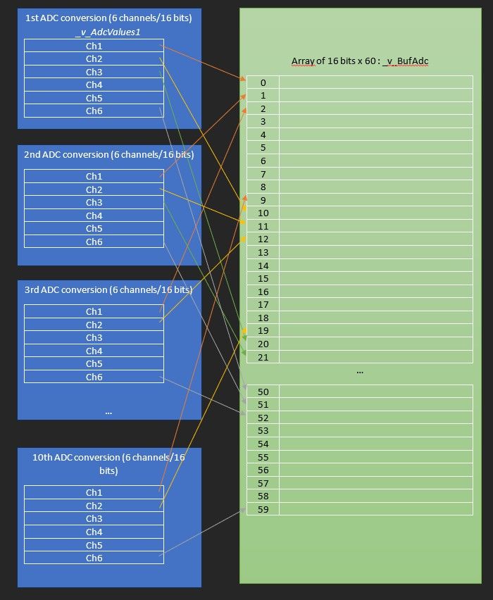

I would like to use MDMA to get values from ADC.
I have one adc set with 6 channels, starting conversion with timer (100µs).
So I would like to save in memory adc values like that :
val1, val2, val3, val4, val5, val6 -> val1(100µs),val1(200µs)...val1(1000µs),val2(100µs),val2(200µs)...val2(1000µs)...val6(1000µs)
the destination memory is 60 values of 16 bits. That means I would like to be interrupted every 1ms by MDMA.
So I use this configuration (at beginning I would like to test only 2 first values val1 and val2):

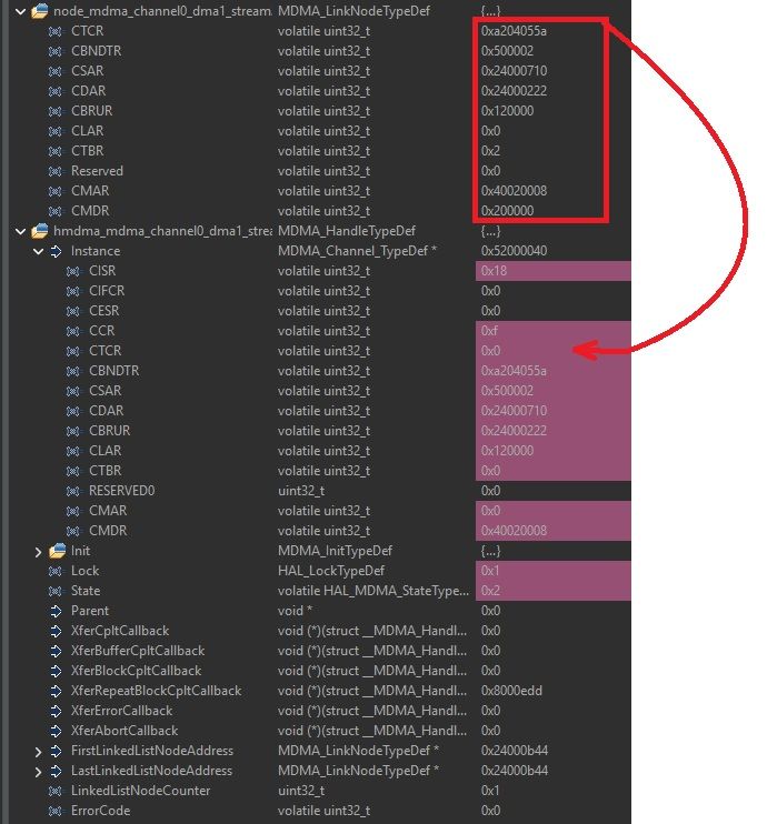

When I run this code, the first time the DMA ends ADC conversion, it works, MDMA copy the 6 values to _v_BufAdc at position 0, 10, 20, 30, 40 ,50.
But the second DMA ends ADC conversion doesn't work.

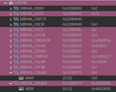

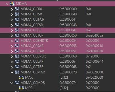

So I checks MDMA registers and I saw something I don't understand :
normally (if I well understood the manual) at the end of the first repeat block transfer, the MDMA registers C0MAR and C0MDR are used to reset the TC flag of DMA (ADC).
but when the function "HAL_MDMA_Start_IT" is executed, and at this line :
    /* Enable the Peripheral */
    __HAL_MDMA_ENABLE(hmdma);
the both registers C0MAR and C0MDR are lost.
before the call of the macro __HAL_MDMA_ENABLE, C0MAR = 0x40020008 and C0MDR = 0x200000 that is correct, and after the macro is executed; registers C0MAR = 0x0 and C0MDR = 0x40020008.
Before macro :
Before macroBefore macro
After macro :
After macroAfter macro
it seems the registers are shifted ?!
Maybe an issue with the MDMA settings ?

-> yes that correct, I draw a bitmap to explain the behavior I would like to have :
So for the first Adc conversion, it's ok, I have the values on index 0, 10, 20, 30, 40, 50
But the issue comes on the first linked list that doesn't work. And MDMA registers are shifted with bad values.
Best regards,

this the copy of memory and MDMA registers when the software halt inside MDMA_RepeatBlockTransferCompleteCallback function :
normally the structure node_mdma_channel0_dma1_stream2_tc_1 is copied to registers after first node executed :
MDMA_CxTCR, MDMA_CxBNDTR, MDMA_CxSAR, MDMA_CxDAR, MDMA_CxBRUR, MDMA_CxLAR,
MDMA_CxTBR, MDMA_CxMAR and MDMA_CxMDR
but here, it seems that the structure is copied starting from register CBNDTR instead of TCR ???

hello
maybe I found the issue, not sure, but now it seems to work :
in file mdma.c generated by CubeMX (all my tools are updated and libraries too) :
MDMA_HandleTypeDef hmdma_mdma_channel0_dma1_stream2_tc_0;
MDMA_LinkNodeTypeDef node_mdma_channel0_dma1_stream2_tc_1;
the data node_mdma_channel0_dma1_stream2_tc_1 is not aligned 64 bits, or i seems that register LAR should have a data aligned 64 bits.
so I change the source code by :
ALIGN_64BYTES(MDMA_LinkNodeTypeDef node_mdma_channel0_dma1_stream2_tc_1);
and now it works.
Could you confirm me that it's the issue ?
Best regards,
Laurent.
