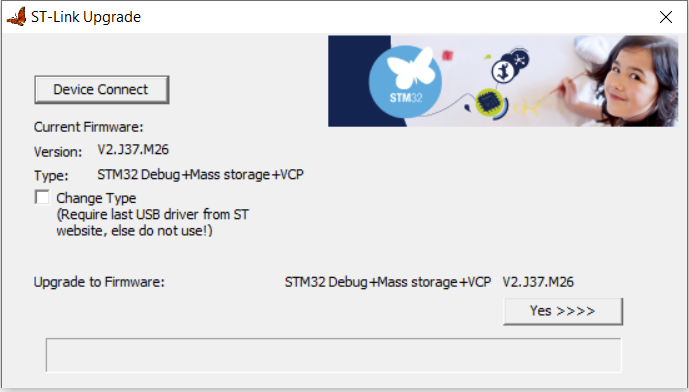

Hi Peter

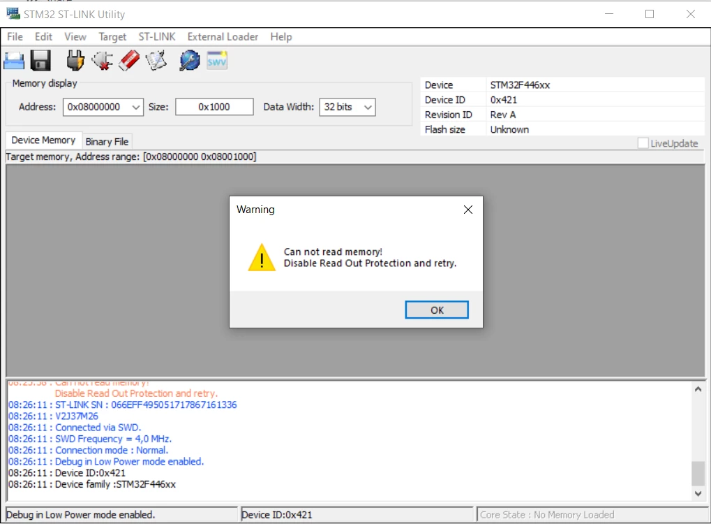

Your purposed method doesn't work either :( 0693W0000059p6DQAQ.pngThe same message (FAIL.txt) pop-up again after I have updated the firmware through the ST-Link Utility. And it also seems that the F446RE already have the newest installed firmware?
I Also get this error-message when i try to connect to the device through ST-Link Utility:

Please don't be confused by firmware versions:
  • the ST-Link Upgrade upgrades the firmware in the ST-Link only, i.e. the debug interface, which in your case contains an STM32F103CB
  • the target microcontroller, in your case the STM32F446RE, does not require upgrades, as it already is either preprogrammed with an example software, or you are program it using your own software - let it call firmware
On your 2nd image I can see the ST-Link Utility is still set to mode Normal.
Please change the Mode via Target > Settings to Connect under Reset and try to connect again.

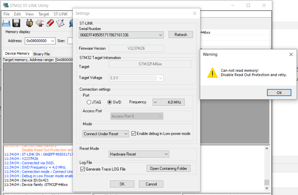

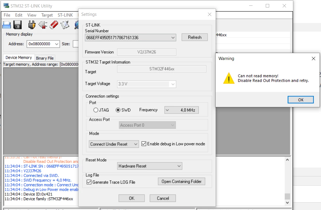

October 30, 2020
Could it be that I accidentally have upgraded the STM32F446RE, and that's why I get the FAIL.txt?
I also changed the settings to connect under reset , but I still can't connect to the board, and the FAIL.txt still pops up.
The LD1, turns green, when i connect through the ST-Link utility, but I still receive the Warning-message as seen on the figure. Based on the UM1724, the LD1 tells that: communication finished and successful. But there must be something wrong, since I still recieve the FAIL.txt?
Sorry for the  inconveniences :(
Peter BENSCH
October 30, 2020
Even that sounds strange indeed, maybe it's for a completely different reason and I'm sorry I missed that: the IO-Link stack is provided by our partner TEConcept, the binary of the firmware is only available there, so TEConcept is very likely protecting the firmware to avoid copying and/or modifying which would explain the message "Disable Read Out Protection and retry".
Please have a look into the UM2421, page 12, where you will find some additional information to upgrade firmware, which requires the IO-Link Control Tool from TEConcept.
