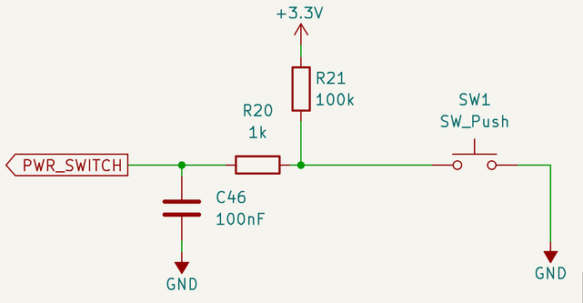

I am using the STM32L433RCT6 and need to assign a GPIO pin as an external interrupt, which will be used to wake and shutdown the MCU (shutdown must use minimal power).
However, I am not sure if I have to use a specific GPIO pin, or if I can use any GPIO pin for the external interrupt ?
The external interrput will be connected to a momentary push button (net PWR_SWITCH)...

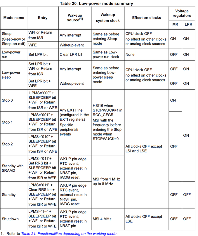

STM32L433 Standby Mode Overview
  • All clocks are stopped (HCLK, PCLKs, etc.)
  • SRAM and registers are lost (except for backup domain and optionally SRAM2 if configured)
  • Only Backup domain, RTC, IWDG, and Wake-up pins remain powered
  • Power consumption is very low (down to ~250 nA)
    result to two ways : 1. RTC periodic wake and check pin (any)  2. Only dedicated pin use to wake
    OR special combine mode RTC tamper or WU pins
    hybrid low-power flow where the STM32L433:
    1. Stays in Standby mode for ultra-low power.
    2. Wakes up on a Tamper (first pulse) event.
    3. Enters Low-Power Run mode temporarily.
    4. Increments a counter stored in backup registers (which survive Standby).
    5. Returns to Standby to wait for the next pulse.
    :white_heavy_check_mark: This is very efficient: you use Tamper to wake from Standby, keep processing minimal, store state in retained registers, and go back to ... manage LED in the middle

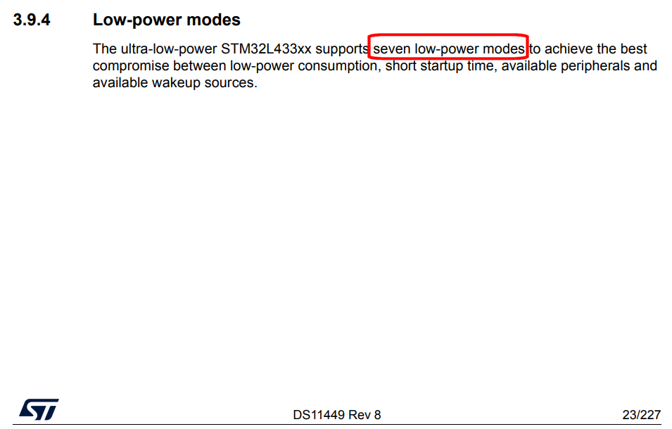

"a low power mode" is not specific, these devices have as many as 7 available.
"low power" is a relative term...
Andrew Neil
Jul 8, 2025 10:48 AM UTC
So, as the others have said, look at its datasheet to see the low power modes available - there are seven to choose from:
https://www.st.com/resource/en/datasheet/stm32l433rc.pdf#page=23
via: https://www.st.com/en/microcontrollers-microprocessors/stm32l433rc.html#documentation
The modes - including their available wake-up sources - are described in Table 4 on the following pages.
See also the Reference Manual, RM0394.

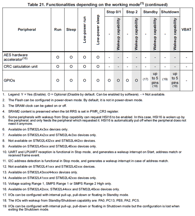

I did see low power modes and how there are 7 types.
But Im not sure which low power mode I need and dont fully understand the information.
Which low power mode would be most suitable for:
  1. Initial wake up using external interrupt on GPIO pin (e.g. on falling or rising edge)
  2. Once woken, run the four-click switch-on cycle (as explained in original post) which requires running code that uses a timer
  3. If the four-click switch-on cycle passes, remain awake and run main code
  4. If the four-click switch-on cycle fails, go back into low power mode

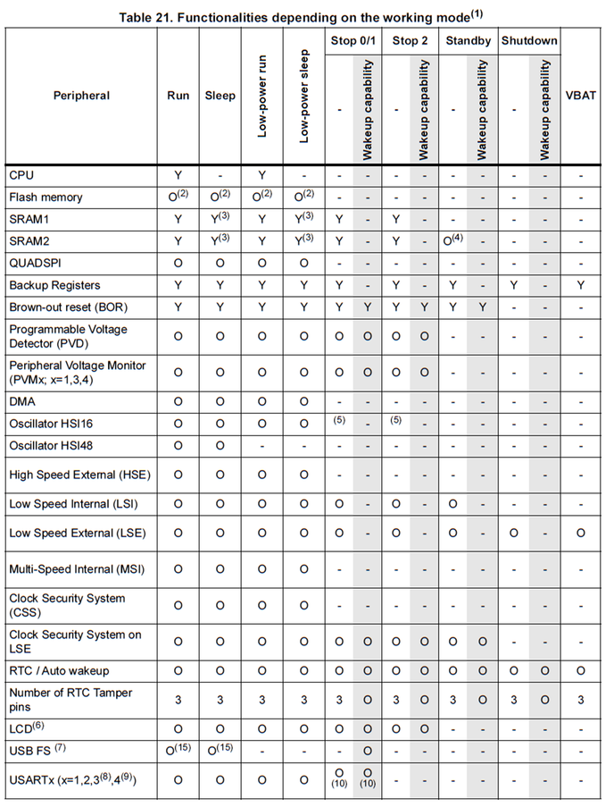

Andrew Neil
Jul 8, 2025 2:28 PM UTC
The key thing that you want is to wake up using a GPIO pin.
So look at the 'Wakeup Source' column to find which modes give the option to wake on a GPIO pin.
This is the only thing that's relevant - the counting of the 4 clicks, etc, is all done once the chip is awake.
Note that waking on a WKUP pin will allow lower sleep currents.

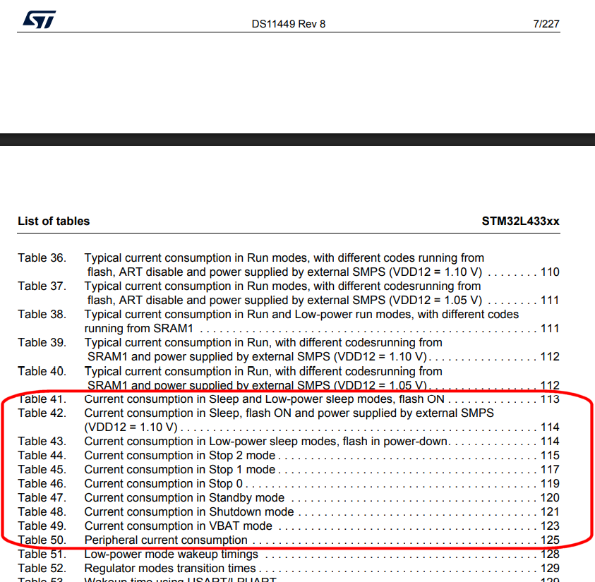

PS:
See Tables 41 and on for the current consumption in the various "low-power" modes
https://www.st.com/resource/en/datasheet/stm32l433rc.pdf#page=113

freeflyerAuthor
Senior II
Jul 8, 2025 3:44 PM UTC
So on the LQFP64...
  1. WKUP1 is on PA0 (pin 14)
  2. WKUP2 is on PC13 (pin 2)
  3. WKUP4 is on PA2 (pin 16)
  4. WKUP5 is on PC5 (pin 25)
(WKUP3 is not available on LQFP64)
In STM32CubeIDE, do I set one of the above pins to GPIO_EXTIx or SYS_WKUPx ?

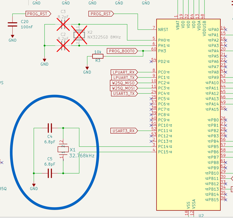

freeflyerAuthor
Senior II
Jul 8, 2025 2:49 PM UTC
Thanks Andrew
Using a WKUP pin becuase it allows for lower sleep currents is the sort of advice I am lookng for (this device is battery powered so effeciency is critical).
This is why I need to find the most appropriate pin and route it on the PCB.  I'm trying to avoid PCB respins as its expensive, so I'm aiming to get tthe design right first time.
I am also using the 32.768kHz low speed external crystal, which I understand generates an 8MHz clock (I copied the design used on the NUCLEO-L433RC-P).  I believe the 32.768kHz low speed external crystal reduces power consumption ?
I have allowed provision for an HSE oscillator clock, but its not fitted.
Andrew Neil
Andrew NeilBest answer
Jul 8, 2025 3:09 PM UTC
You can see that from the tables: the "deeper" sleep modes have only WKUP (not GPIO) as possible wakeup sources.
If that's now answered your question, please mark the solution.
That's a whole new question - please start a new thread for a new question.
TL;DR: it depends ...
