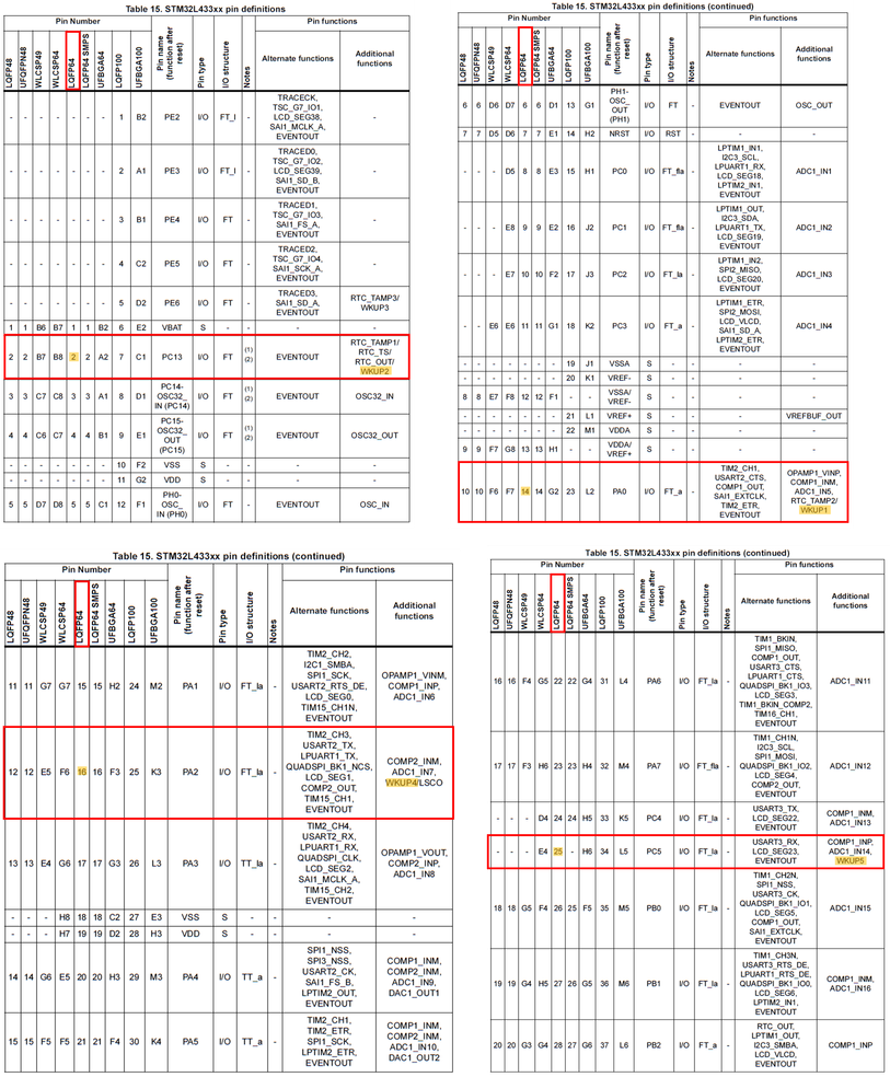

@freeflyer wrote:
Using a WKUP pin becuase it allows for lower sleep currents is the sort of advice I am lookng for
You can see that from the tables: the "deeper" sleep modes have only WKUP (not GPIO) as possible wakeup sources.
If that's now answered your question, please mark the solution.

MM..1
Chief III
After approx. one second, an LED will flash require timing and advanced current of running MCU 1s = waste battery.
Next waste is lighting LEDs 4x usw.
So on the LQFP64...
  1. WKUP1 is on PA0 (pin 14)
  2. WKUP2 is on PC13 (pin 2)
  3. WKUP4 is on PA2 (pin 16)
  4. WKUP5 is on PC5 (pin 25)
(WKUP3 is not available on LQFP64)

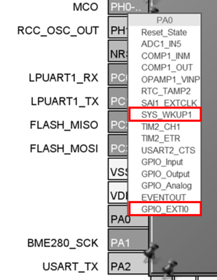

In STM32CubeIDE, do I set one of the above pins to GPIO_EXTIx or SYS_WKUPx ?
You want to use it as WKUP - not EXTI - so set it to SYS_WKUPx
EXTI for STOP and up modes. WKUP for STANDBY and SHUTDOWN.
EXTI is limited to one pin on one line for example PB0 EXTI result cant PA0, PC0 ...
