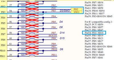

Yes i saw that. I have tried by changing the jumper position and even i have tried by removing both the jumpers. While removing both the jumpers, i probed at controller pin.
‎2024-06-13 9:11 AM

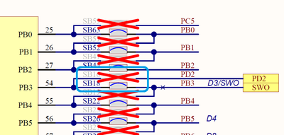

As I said need to check SB16 and SB18 solder bridges.

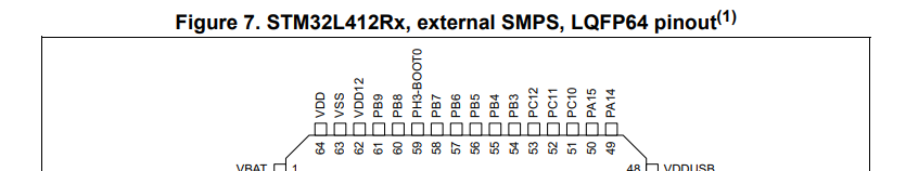

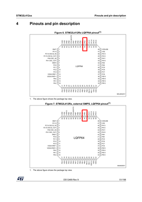

Have a look on this. PD2 is at 54th pin. I think you have selected some different series. Am using STM32L412RBT6

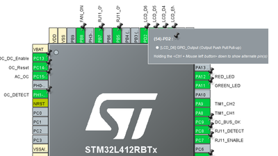

No I didn't select other series, in my project pin 54 is well PD2, so please check the zip file attached and test the project and don't forget to check the status of SB16/SB18.

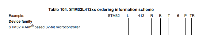

Pin 54 is either PB3 or PD2, depending on which particular model of STM32L412 are you using - the suffix is important.
So, post a photo of the chip you are using.

Yes exactly @waclawek.jan . I found that and i tried to toggle PB3 pin, it is working fine and i can able to see the pulses at 54th pin. So finally our ordered part is wrong.
‎2024-06-16 11:18 PM - edited ‎2024-06-16 11:21 PM
So look at your chip, to see, what you have:
with P or not ? (you should find the P ...) :)
