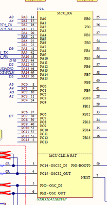

No its a LQFP64 package. Please check the snap which i took from the NUCLEO-412RB schematic
‎2024-06-13 8:42 AM - edited ‎2024-06-13 8:42 AM
Umm well unfortunately I don't have this board (NUCLEO-64) on hands but I can provide you a very simple project on which I toggle PD2 and you can test from your side and get back with the result.
But you didn't answer that question: do you confirm that even with NUCLEO-L412 board you're facing the same behavior?
‎2024-06-13 8:47 AM
But pin 54 is PB3 , not PD2 . Right ?
Which LED is there ?

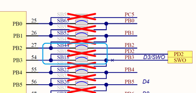

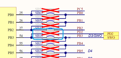

But also need to check the solder bridges SB16 and SB18:
SB16: needs to be soldered and SB18 needs to be disconnected.

Sorry i forgot. Yes we are facing the same behavior in NUCLEO-L412RB board. As you can see that in schematic, PD2 is not going anywhere and it is coming directly to the connector. I have probed at the connector as well as in controller pin (54th).

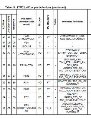

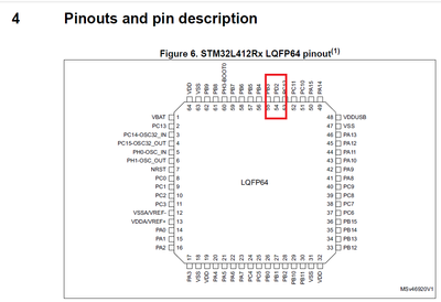

‎2024-06-13 9:09 AM - edited ‎2024-06-13 9:09 AM
According to the datasheet pin 54 is PD2:
But in CubeMx if you create a project based on the NUCLEO-L412 board you get pin 54 is PB3! It's based on the default solder bridge SB18 soldered/SB16 disconnected:
