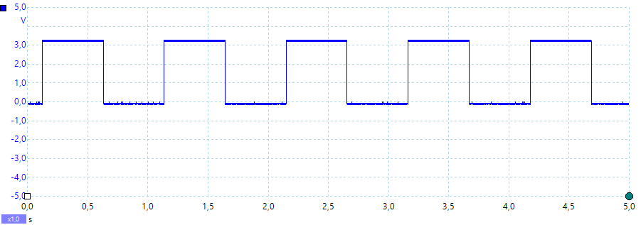

i have a problem with the RTC Calib Out (1Hz) on PB2 and TimeStamp Input PC13 (Board: NUCLEO-L4R5ZI).
- PPS (1 Hz clock) should be on PB2 (RTC_Calib_Out) for time synchronization with other chips.
- PC13 should be configured as TimeStamp Input for events (e.g. 1 Hz)
Calib Out on PB2
With the following code works the calib out pin fine.
hrtc.Instance = RTC;
hrtc.Init.HourFormat = RTC_HOURFORMAT_24;
hrtc.Init.AsynchPrediv = 127;
hrtc.Init.SynchPrediv = 255;
hrtc.Init.OutPut = RTC_OUTPUT_DISABLE;
hrtc.Init.OutPutRemap = RTC_OUTPUT_REMAP_POS1;
hrtc.Init.OutPutPolarity = RTC_OUTPUT_POLARITY_HIGH;
hrtc.Init.OutPutType = RTC_OUTPUT_TYPE_OPENDRAIN;
HAL_RTC_Init(&hrtc);
HAL_RTCEx_SetCalibrationOutPut(&hrtc, RTC_CALIBOUTPUT_1HZ);
HAL_StatusTypeDef HAL_RTCEx_SetCalibrationOutPut(RTC_HandleTypeDef *hrtc, uint32_t CalibOutput)
__HAL_LOCK(hrtc);
hrtc->State = HAL_RTC_STATE_BUSY;
__HAL_RTC_WRITEPROTECTION_DISABLE(hrtc);
hrtc->Instance->CR &= (uint32_t)~RTC_CR_COSEL; /* Clear flags before config */
hrtc->Instance->CR |= (uint32_t)CalibOutput; /* Configure the RTC_CR register */
__HAL_RTC_CALIBRATION_OUTPUT_ENABLE(hrtc); // ((hrtc)->Instance->CR |= ((0x1UL << (23U))))
__HAL_RTC_WRITEPROTECTION_ENABLE(hrtc);
hrtc->State = HAL_RTC_STATE_READY;
__HAL_UNLOCK(hrtc);
return HAL_OK;

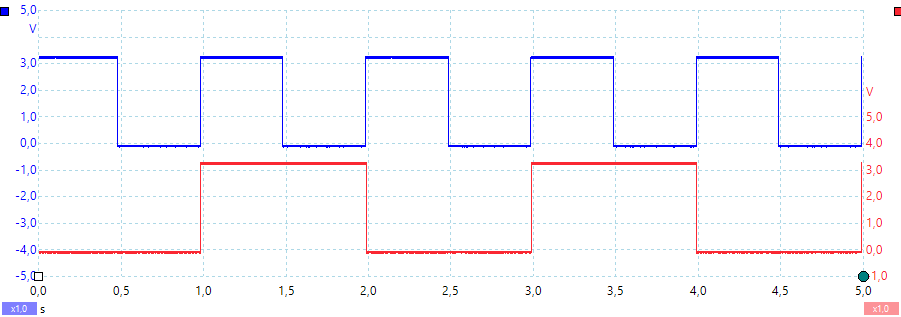

TimeStamp Input on PC13
Is only only the TimeStamp function configured, then it works also as expected. Blue is a clock with e.g. 1 Hz and the red signal is a gpio which will be toggled by the TimeStamp callback function. It works also as expected.
HAL_RTCEx_SetTimeStamp_IT(&hrtc, RTC_TIMESTAMPEDGE_RISING, RTC_TIMESTAMPPIN_DEFAULT); // default PC13
HAL_StatusTypeDef HAL_RTCEx_SetTimeStamp_IT(RTC_HandleTypeDef *hrtc, uint32_t TimeStampEdge, uint32_t RTC_TimeStampPin)
uint32_t tmpreg;
__HAL_LOCK(hrtc);
/* Get the RTC_CR register and clear the bits to be configured */
tmpreg = (uint32_t)(hrtc->Instance->CR & (uint32_t)~(RTC_CR_TSEDGE | RTC_CR_TSE));
tmpreg |= TimeStampEdge;
/* Disable the write protection for RTC registers */
/* Configure the Time Stamp TSEDGE and Enable bits */
hrtc->Instance->CR = (uint32_t)tmpreg;
__HAL_RTC_TIMESTAMP_ENABLE(hrtc);
/* Enable IT timestamp */
__HAL_RTC_TIMESTAMP_ENABLE_IT(hrtc, RTC_IT_TS);
/* RTC timestamp Interrupt Configuration: EXTI configuration */
__HAL_RTC_TAMPER_TIMESTAMP_EXTI_ENABLE_IT();
__HAL_RTC_TAMPER_TIMESTAMP_EXTI_ENABLE_RISING_EDGE();
__HAL_UNLOCK(hrtc);
return HAL_OK;

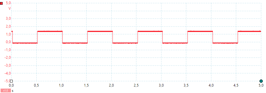

Both together (doesn't work)
If I try both together, the calib out will work, but I won't get any TimeStamp events anymore. The signal at the TS input has only a voltage of 1.4 volts. Only the COE and COSEL bits are changed by the pin calib out. What happens here?
Can someone explain what changes to PC13 when the COE bit is set to 1?
