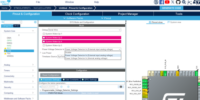

As an example on STM32L476 device (Nucleo-L476RG)
According to DS10198 Rev 11 in Table 16. PVD_IN is an additional function connected to PB7.
And in RM0351 Rev10, PVD can be configured in PWR_CR2 bits PLS[2:0] = 111.
In STM32CubeMX here the possible PVD levels configurations:

DS10198 Rev 11 and RM0351 i read before. But I didn't see information for the GPIO configuration nor the VRefint configuration.
From MX Cube I see, that PB7 is configured as analog with no pullup/down.
This was also my intention but i didn't find it in the docs.
