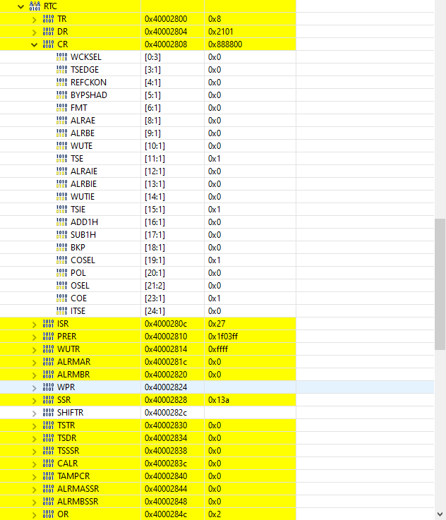

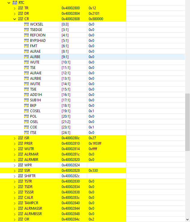

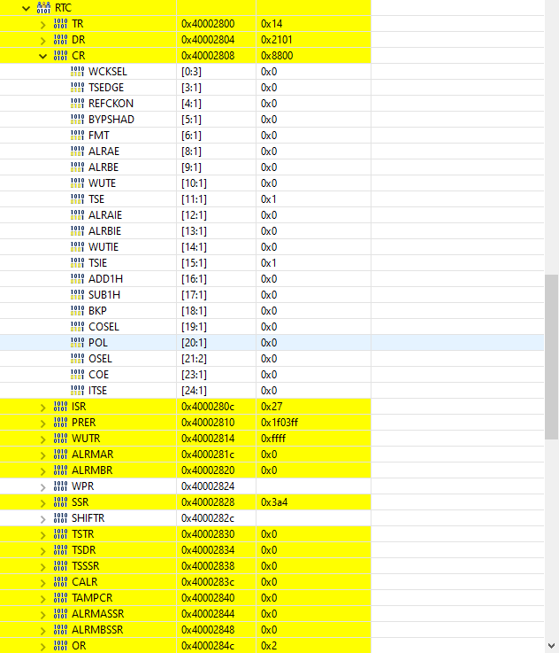

OK so if you read out the RTC registers, what exactly do you see in those bits, in all three cases?
‎2020-06-27 3:40 AM
I guess i see what i expect.
Case 1
Case 2
Case 3
‎2020-06-27 4:49 AM
Indeed looks logical.
Pity you did not show us the registers when the external 1Hz signal is connected to PC13/RTC_TS - according to your description, at least in case 2 that should have effect on the registers.
I wonder, whether in case 3 that does or does not have similar effect on the registers.
[case 3]

‎2020-06-29 1:11 AM
The external signal is the same in case 2 and case 3.
The only difference between case 2 and case 3 is that in case 2 only the RTC_TS is configured (see TSE and TSIE bit).
In case 3 RTC_Calib_Out is also active (see COE and COSEL bit).
In case 3 the voltage is 1.4 V instead of 3.3 V. That's the question. This happens when PB2 is active, but why does it change PC13.

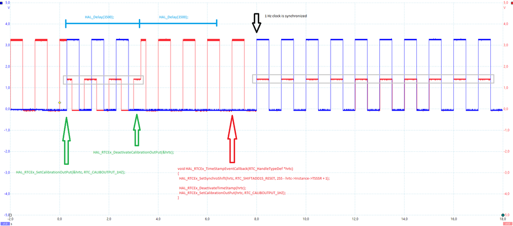

‎2020-06-29 10:40 PM
This sounds like PC13 is turned to output, in spite of TSE bit being set.
Sounds much like a hardware bug.
@Imen DAHMEN​ , can this please be checked? Thanks.
Jan
‎2020-07-01 12:45 AM
‎2020-07-01 12:49 AM
I wouldn't hold my breath and would work out of the premise that the given combination is simply unavailable. Maybe combination of retaining the tamper function and toggling a pin in RTC interrupt might provide something close to what you intended?
‎2020-07-02 10:26 AM
I wanted to use the RTC_TS for time synchronization because a rising edge triggers an interrupt and at the same time the current time is transferred to the TS register.
With the timestamp I would know how many sub-seconds the RTC of the L4 deviates and could correct this with the shift function.
void HAL_RTCEx_TimeStampEventCallback(RTC_HandleTypeDef *hrtc)
HAL_RTCEx_SetSynchroShift(hrtc, RTC_SHIFTADD1S_RESET, 255 - hrtc->Instance->TSSSR + 1);
HAL_RTCEx_DeactivateTimeStamp(hrtc);
HAL_RTCEx_SetCalibrationOutPut(hrtc, RTC_CALIBOUTPUT_1HZ);
Example
HAL_RTCEx_SetCalibrationOutPut(&hrtc, RTC_CALIBOUTPUT_1HZ);
HAL_Delay(3500);
HAL_RTCEx_DeactivateCalibrationOutPut(&hrtc);
HAL_Delay(3500);
HAL_RTCEx_SetTimeStamp_IT(&hrtc, RTC_TIMESTAMPEDGE_RISING, RTC_TIMESTAMPPIN_DEFAULT);
The blue signal is the calibration output and the red signal is the 1 Hz clock with the RTC is to be synchronized.
So that I get an RTC_TS interrupt, I always have to switch off the caliboutput. If the COE bit is set, as you said, the RTC_TS may be configured as an output.
‎2020-07-03 5:03 AM
@Community member​
I have assigned PB2 with RTC_Caliboutput and PC13 as exti input with rising edge.
PC13 cannot be used. The input signal is always 1.4 V.
