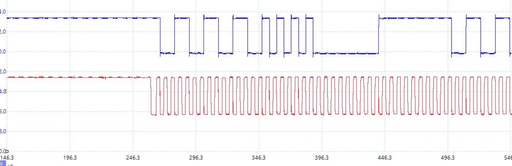

Since I suspect that DMA has nothing to do with the SPI behavior, I tested SPI without DMA.
Since the SPI has 32 bit FIFO, I loaded 4 bytes. Later the clock starts. I would expect all 4 bytes output correctly. But I, in fact, get 5 bytes, the first being sent twice.
Here is the code:
 LL_SPI_StructInit(&SPI_Init_ToFromRadio);
// change non-defaults to what we need
 SPI_Init_ToFromRadio.NSS = LL_SPI_NSS_SOFT;
 SPI_Init_ToFromRadio.BitOrder = LL_SPI_LSB_FIRST;
 LL_SPI_DeInit(SPI3);
 LL_SPI_Init(SPI3, &SPI_Init_ToFromRadio);
 LL_SPI_Enable(SPI3);
 LL_SPI_TransmitData8(SPI3, 0x33);
 LL_SPI_TransmitData8(SPI3, 0x55);
 LL_SPI_TransmitData8(SPI3, 0);
 LL_SPI_TransmitData8(SPI3, 0xff);
The SPI is doing it, not DMA
Here is the logic analyzer trace of what happens on the SPI data out line, and the clock
It was captured using the code above. You can clearly see that the first 0x33 comes out doubled, followed by 0x55, 0x0 and 0xff.
Since I do not stop the clock after that (being the test code), the SPI continues outputting 0x33, I guess it is the SPI behavior when in underflow condition.
What is important is that the SPI peripheral is deInit and re-init every time when I call this code. IMHO it points to a racing condition in the SPI IP becase different clock rates behave differently with the same code.
What do you think?

waclawek.jan
February 3, 2020
Yes, I've been explicitly assured here by ST that this is the case, can't find the thread at the moment.
> No, the idle state doesn't depend on the clock.
But obviously it's not 0 while you set CPOL to 0.
Note this line in RM:
The SCK signal must be settled at an idle state level corresponding to the selected polarity before the SPI slave is enabled.''

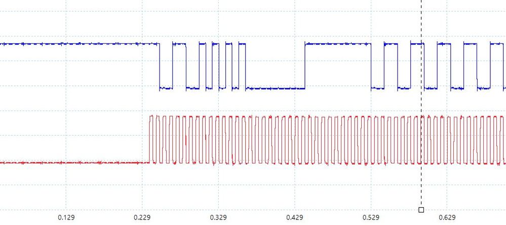

sergey239955
February 3, 2020
Well, it appears I was wrong, because I made an assumption (wrongly) that the idle state of the clock doesn't depend on the rate. It does.
Below is the correct behavior of SPI at a different rate.
Looks like the transceiver is acting differently at different rates, and the SPI responds differently.
waclawek.jan
February 3, 2020
Okay, so problem solved?

sergey239955
February 3, 2020
Thank you JW for asking all right questions, and other guys for spending your time helping out.
I am sure the idle clock polarity is what causes SPI to behave this way. I kinda feel stupid for assuming too much. Too much emphasis was made on the fact that it is migration from a working project. Too much time spent looking at the code and not probing the lines.
Cheers!
sergey239955
February 3, 2020
Yes, it is solved. Thanks!
