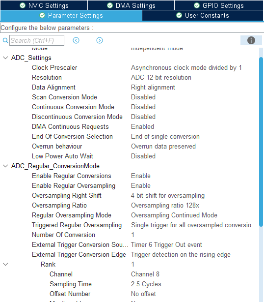

0693W00000SvsRqQAJ.pngI want to use the adc 15bit resolution.
I don't understand why right shift and oversampling ratio are at the same time.
1. what is difference
12bit + 4bit right shift + oversampling ratio 128x
and
12bit + oversampling ratio 8x?
2. What are the functions and roles?
Please give me a detailed answer that is easy to understand

What's the reason for doing the right shift?
waclawek.jan
September 22, 2022
If you oversample by 2^N (N=7 in case of oversampling by 128) the 12-bit ADC result is added 2^N times, resulting in 12+N-bit number (in case of N=7 it's 19 bits). The ADC data register is only 16-bit, so if the mcu wouldn't right-shift before moving the result from the 20-bit internal accumulator into ADC data register, the uppermost bits (19-16=3 in case of N=7) would get lost.

so then, what is difference 12bit + 4bit right shift + oversampling ratio 128x and 12bit + oversampling ratio 8x?
Both are equal to 15 bits ADC.
noise? anti-aliasing? or what?
waclawek.jan
September 23, 2022
Your measurement will take 128x longer but you'll have cca 11x less noise.
[EDIT] see Piranha's post below - indeed, I compared it to single conversion which wouldn't return 15 bits, so it's an incorrect comparison[/EDIT]

An oversampling of 128x compared to 8x will take 128/8=16 times longer and will give sqrt(16)=4 times less noise.
