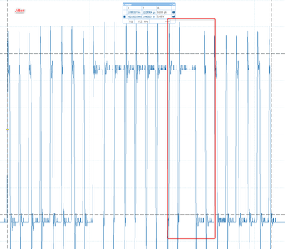

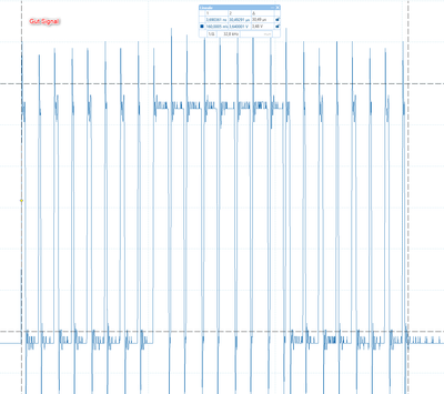

2025-05-12 11:30 AM
I tested a single LED with red color using PWM and DMA. The signal was mostly correct, but occasionally the LED displayed white instead of red.
Bad signal.
Do you have an idea what could be causing this issue?

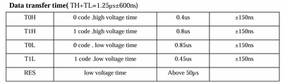

> Do you think I really don't need an external crystal to control the SW2812?
Required timings seem pretty generous, don't they?
