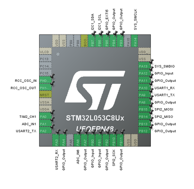

We have a custom design based on STM32L053C8U8 with the pinout mapping as image attached. The GPIOs setting and initialization code is generated by STM32CubeIDE version 1.17.0 and companion CubeMX . however, the GPIO level the output pins are not in line with the firmware control using HAL_GPIO_WritePin(). for example, HAL_GPIO_WritePin(GPIOA, GPIO_PIN_11, GPIO_PIN_RESET) won't sew the PA11 to LOW.
The initialization code is attached.
What's wrong? thanks in advance and appreciate your responses!

It's resolved. For those who will see the same problem, this is due to the fact that VDD_USB pin of the STM32L053C8 did not pull up resulting PA11 (and PA12) are not usable.

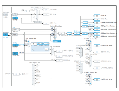

Thanks; It's been debugged and step though many times. the code run properly just that the affect on the gpio output is not as desired ... it happend on random GPIOs on different chips
here is the clock tree:
thoughts, ideas?

Double check what speed the chip is running, perhaps confirm via PA8/MCO, double check flash wait states, power.
Plots from Cube show what you wanted, register bit settings might illustrate what you got.
