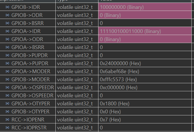

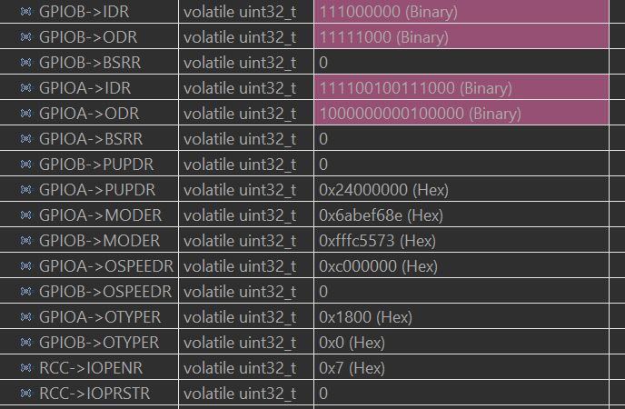

Now PB4, PB5, PB5, PA5, and PA15 are floating, configured as output, low speed, pushpull and no pullup/pulldown resistor. The very basic output configuration.
ODR react perfectly at my command, I tried using ODR register and BSSR register as well. In both cases, ORD toggle also the way I want. I just dont have voltage on certain of my output pin, as IDR shows below. I also checked every pin that I could put as output, they are all working perfetcly fine but the one I said and also PB1 that have the same problem. In the picture and code below, I just show the main output that i'm interessed in, not all of them.
So to resume :
PB1, PB3, PB4, PB5, PB6 and PA15 are uncontrollable (ODR = 1, IDR = 0) as a basic output push pull no drain, pin not connected to anything.

I even manually put 3,3V on all the problematic GPIO to check if IDR would change.
It does work for all the pins but the one that have a problem already, so it doesn't seems to be a configuration problem but a STM32 problem. I cannot provide a good big zoom on the STM32 soldering.
PB1 is set to input mode, but the others should work.
Can you measure the overall current consumption? Does it go up when you try to output those high? If so, probably a short on the board.
The chip could also have been damaged.
If the pins are now disconnected from everything else, measure resistance or diode drop between them and ground and vdd using a multimeter and compare those to working pins when power is off. If the ESD diodes are shot due to overvoltage, they will provide dramatically different readings.

Thanks for the answrer.
We don't see any current rise of the current when I try to change the state of the outputs.
We tried to measure the resistance/diode, and we cannot see any fun readings when we compare the outputs that have a problem and normal ones.
We tried a 3rd microcontroller on a 3rd PCB (same design, but the pcb have been carefully reviewed. Only soldered on the PCB : the power supply, the 3,3V LDO and pin for the ST-Link).
PB1 was set as an input on the example I gave you, but I tried with the output configuration and it does not work.
