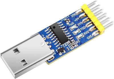

Thanks for suggestion. Are there any other methods available? The board that I am designing is a very small device and using 14 pin connector might be an issue. I am already stretching it by using 10 pin connector...
My other idea:
use 6 pin Tag Connect for flashing and debugging and route USART2 RX/TX pins to some external header where I can connect USB->UART converter such as:
That would allow me to use printf to console.
Is my idea correct?
No problem. Get rid of the standard connector, solder the wires directly to the ST-LINK contacts. It is cheap.
Or consider a hole & needle connector (the cable is more expensive). Same, 10 pin.
