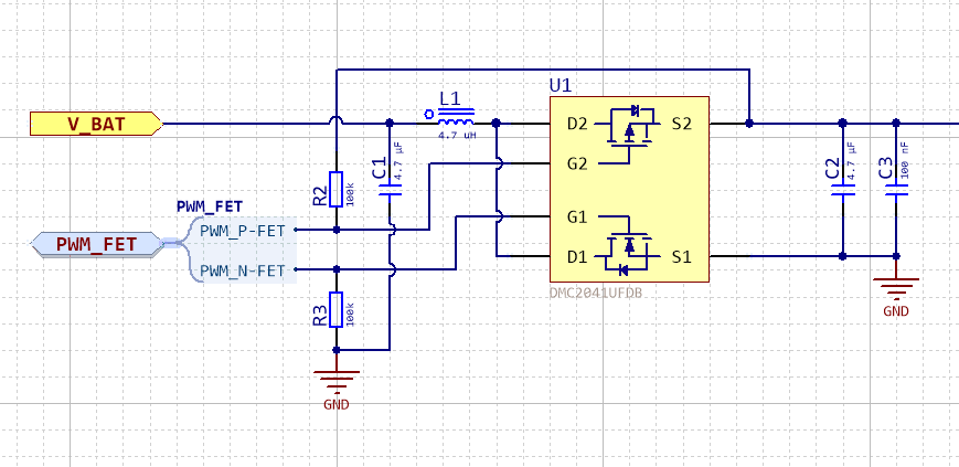

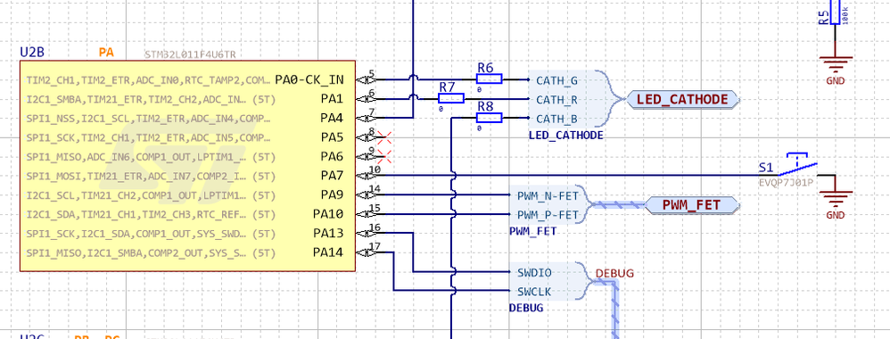

I have the problem that apparently PA9 is in HIGH state after applying the supply voltage to my circuit.
The problem is, that it is connected to the gate of a N-Channel FET which you can see in this image shorts the supply voltage to ground right from the start, making it unable to communicate with the MCU.

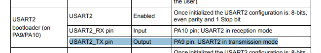

2018-06-26 4:32 AM
On page 194 of that application note it says:
Does ''Output'' then mean that VDD is applied at that pin?
2018-06-26 5:11 AM
The bootloader first does nothing just 'listens' on the *Rx* pin (i.e. PA10). If it 'sees' 1->0->1 transition there (with some rough measurement of the timing), it then enables the USART and switches the USART pins in GPIO to AF - which for Tx means 1 initially (as that's the idle state of USART Tx).
From your schematics I can't determine whether such 1->0->1 transition may be present on PA10. You may want to keep the mcu in reset until programmed.
2018-06-26 11:38 AM
That Rx-sequence can be excluded as these 2 pins are connected to the Gates of a P-N-Dual-Mosfet.
The problem I'm facing now is if I solder an additional cable to the reset pin and connect this to the ST-Link's RST-pin, it isn't able to connect because my circuit draws to much current which fails the ST-link. And if I hold the reset-line LOW manually, the ST-link utility tells meIt only works if I remove the Reset-line from GND during a connection attempt. Then it get's a successful connection. Once the connection is established it connects again if i hit connect again.
