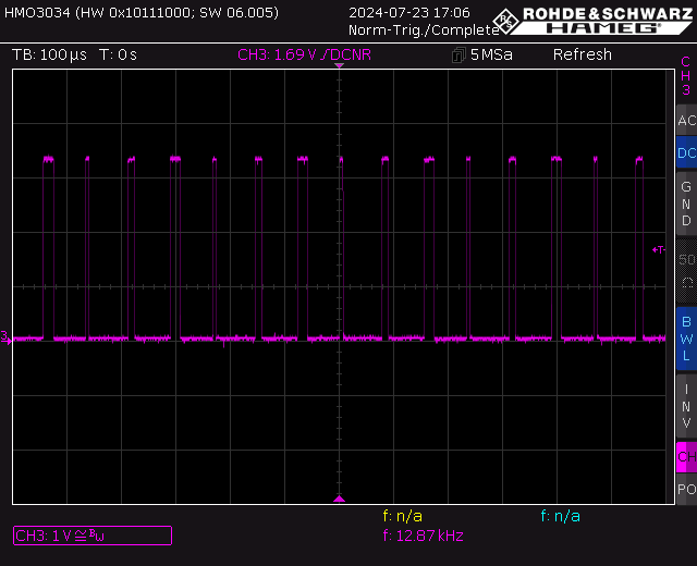

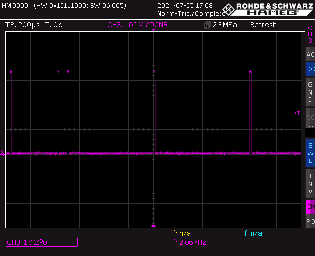

Read from RAM:
The PWM output Pin of CCR4 looks correct this if DMA source is defined: uint16_t source[3] = { 200, 400, 600 };
Read from flash:
The PWM output Pin of CCR4 looks like this if DMA source is defined: const uint16_t source[3] = { 200, 400, 600 };
TIM2->ARR = 2499;
TIM2->PSC = 0;
If I read TIM2->CCR4 or TIM2->ARR randomly via UART, values are shown correctly. But PWM output appears randomly.
This routine works well if I use timer update interrupt instead of DMA for changing CCR4. But CPU load is high. In this case source is read by processor inside the interrupt routine.

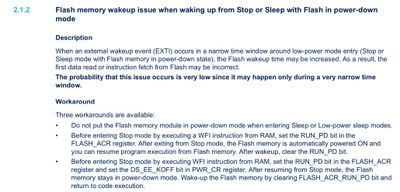

2024-07-23 4:32 PM
Dear @Marc1 ,
Can you try to execute these two instructions from RAM instead ? And let us know - you can put them in a C function that you call from RAM . I see we have an errata on early silicon revisions and seems an extra time is required for Flash to be ready after wake-up
let us know .
STOne-32
2024-07-24 1:12 AM
Hi @STOne-32,
Thank you for replying. What two instructions do you exactly mean?
Your article describes a procedure during power-down and during wake-up. In my case there is no wake-up event before using DMA.
2024-07-24 1:56 AM
Hi @Marc1 ,
These two instructions :
PWR->CR = PWR_CR_CWUF | PWR_CR_LPSDSR;
WFI();to have function like Lowpowerentry(); Link it to be executed from RAM Area at linker file or using pragma to force it. The goal is to make a trial and see what happens ?
Thank you
