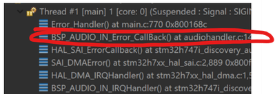

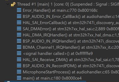

I am trying to fill a buffer from the on-board MEMS microphone using the BSP_AUDIO_IN_RecordPDM() function. However, execution pauses around HAL_SAI_Receive_DMA() and the BSP_AUDIO_IN_IRQHandler() is called. The stack trace is as follows:

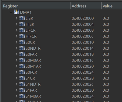

Checking the hdma variable on the debugger, I can see the error code is 1, corresponding (I believe) to a transfer error. I tried looking at the relevant registers with breakpoints, but they were at 0x0 at every point:
I've tried almost everything under the sun. I disabled the D-Cache and allocated all the memory to RAM_D1, I tried allocating my buffer (copied below) to each of RAM_D1, D2, and D3

Where exactly is Error_Handler being called and why? Stack trace is there, should be easy to find out.
miloa
Sorry, I'm not entirely sure I understand. I've only been using the IDE for a few weeks so I may be missing something. Is there something I can print out from inside the Error_Handler to help me debug? The function itself takes in no arguments.
Unless you mean following the stack trace, in which case it looks like the HAL_SAI_Receive_DMA() function is erroring in line 9 in the code below (although it sometimes errors in line 16). After that the stack trace has a "signal handler" at 0xffffffe9 which the IDE is unable to show me, and after that it enters the cascade of interrupt handlers.

This is where Error_Handler gets called according to the stack trace.
miloa
Not a lot going on there...
  * @brief  Audio IN Error callback function
  * @PAram  None
  * @retval None
void BSP_AUDIO_IN_Error_CallBack(uint32_t Instance)
  /* Stop the program with an infinite loop */
  Error_Handler();
So keep going down the chain until you see why it was called.
HAL_SAI_Receive_DMA is in the main thread, before the interrupt happened. Error handler was called within the interrupt.
It could be that your buffer is located in a place that DMA cannot access.
miloa
I know, the issue is that signal handler I am unable to read is that critical spot between HAL_SAI_Receive_DMA() and the interrupt
miloa
That's what I've been thinking, but I don't know what I might be doing wrong in that regard. That's why I posted my linker script and buffer location.
