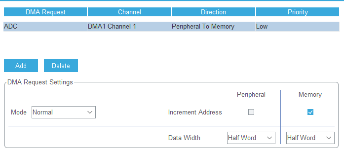

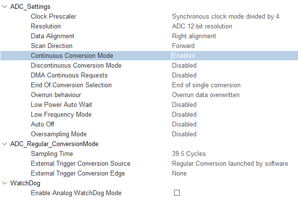

I am trying to read 2 channel ADC with STM32L011F4.
My ADC and DMA settings in cubemx are as follows0693W00000NpJS3QAN.png0693W00000NpJSIQA3.png
my problem is that the DMA only returns the low 8 bit of the last channel.

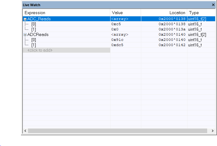

EWARM live watch screen looks like below
