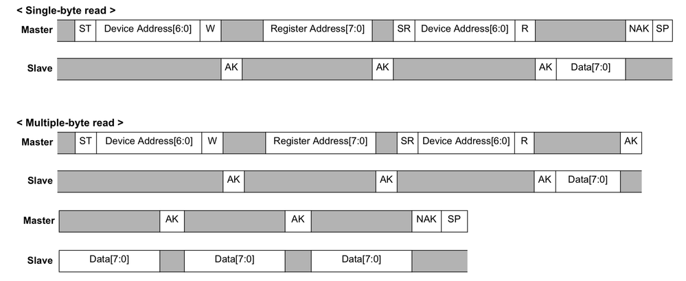

I am trying to communicate with a commonly used Accelerometer form NXP (MMA8451) which uses repeated start sequence over I2C protocol, which should look like this:
My problem is that the MCU doesn't seem to send a NACK at the end of transmission and may cause the communication to fail.

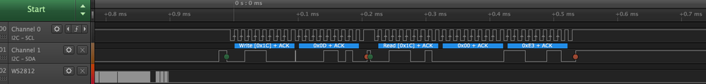

This is what I am reading using a logic analyzer
and here is my code:

While there doesn't seem to be a problem, the MMA8451_readRegister() function is never allowed to repeat because it is stuck waiting for a
while(!(I2C1->SR1 & I2C_SR1_SB)) condition.
I don't know what am I doing wrong, when I use stops after starts the condition clears and the MMA8451_readRegister() is allowed to repeat.
I need to use repeated start to read the data from chip, but the flags don't clear.

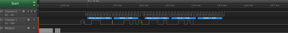

Here is what I am reading with a logic analyzer without the repeated start and when I send Stop after Start
0693W0000000B6XQAU.pngThe while(!(I2C1->SR1 & I2C_SR1_SB)) condition clears and lets the MMA8451_readRegister() to be repeated infinitely every 10 ms
