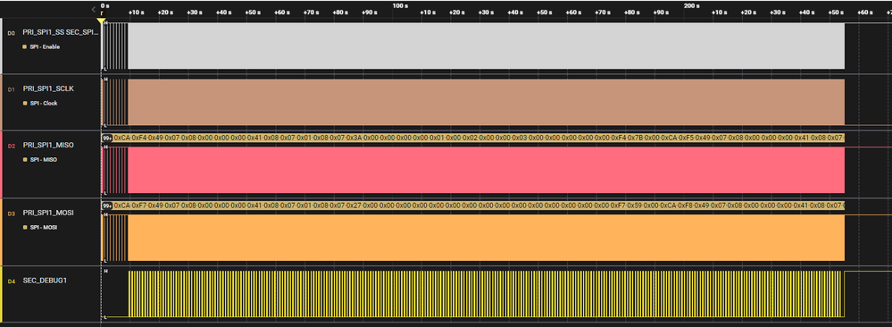

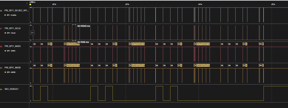

However, to speed up the process, I would like to bump up the transfer size to potentially 256 or more. Yet, as the first attempt at transfer size of 64 bytes, it has a hiccup. The process goes for a while and then runs into an issue, which appears to be interrupt not firing! So, it hangs waiting for the completion interrupt after the HAL_SPI_TransmitReceive_DMA call. What's difficult to troubleshoot is that the process goes say about 15K bytes of transfer with all the transfer size of 64 bytes on each transfer before the hiccup happens. What's interesting though is that all the time that is is working well, the MISO is transmitting 0xA5 (which is what I do desire to send on MISO) while reading the MOSI bytes. However, upon the hiccup, it appears to have 7 or 8 bytes of 0xA5 sent on MISO, but the remaining bytes of that 64 byte transfer are some unexpected data or at 0xFF (MISO staying high). This may not be related, but nevertheless, could be a clue to the issue. Here are Logic Analyzer captures:

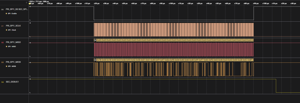

0693W00000aJ9YTQA0.pngFYI, in above, every toggle on "SEC_DEBUG1" is after the interrupt and toggled in the callback (HAL_SPI_TxRxCpltCallback) routine. As you can see the last transfers (256 bytes, which is split into four 64 bytes) are not getting the interrupt. Moreover, on a good transfer, all the MISO bytes are 0xA5 (see below):

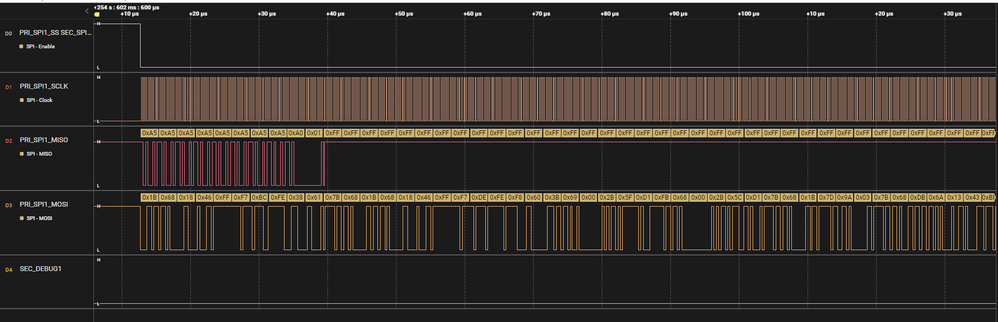

However, at the end where it starts having the issue, I only see 8 bytes of 0xA5 from MISO and then the rest are not what I am expecting and EOT interrupt does not fire... (see below):

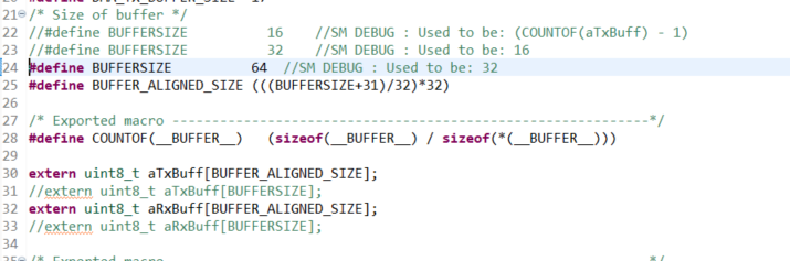

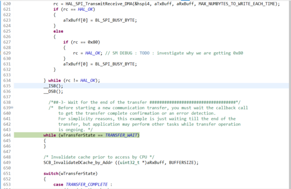

Here are the snippet of the code at the hiccup point waiting for interrupt call back routine to set the EOT completion and the related define and variable info:
Note: In above image, if resolution is small, I have also attached the image (SPI_DMA transfer hiccup.jpg).
