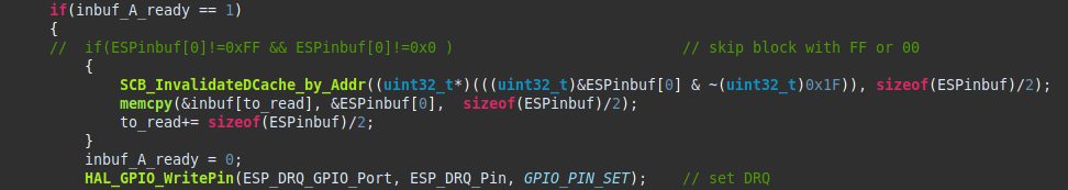

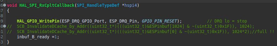

0693W00000aICNCQA4.png0693W00000aICNHQA4.png0693W00000aICNRQA4.pngnow it is running, always ...when data from spi comes, then copy from input buffer (in callback just set flag: buffer ready):
0693W00000aICNgQAO.pngcache "clear" was not effective here, so i put it only just before using the buffer ->
then copy it, when needed (and clear flag :(
0693W00000aICNlQAO.pngdata from ESP is 8bit , at 12 Mbaud speed; no dropouts or errors (at used speed);
why using HAL ? just because overall speed is not high, a 2KB data block needs minimum 2ms , so "slow HAL" calls add some 2us or so...not intersting, to bother around with the registers... :) ; would not make anything faster or better, because the data rate is coming from the source and has big interval breaks up to 500ms ;
internet radio :) .

The cache maintenance is just flawed. You are doing the broken "adjustment" of invalidation function parameters, the second invalidation is missing and the buffer is probably not aligned properly. Just read my article, a link to which I posted below!
Also HAL is not only bloated, but also broken:
https://community.st.com/s/question/0D50X0000C5Tns8SQC/bug-stm32-hal-driver-lock-mechanism-is-not-interrupt-safe
Engineering is not about luck. It is about understanding the issues and solving them correctly.
Well, surely and the use of the word "luck" was not the right choice. I should have said:...I didn't get the expected result there and so...
@Piranha​  ok, i know, you dont "like" the HAL :)
but what i am doing wrong ?
hm ? invalidateCache .. is wrong? maybe i can use the MPU - but i didnt find a simple and clear "how to do " . simple test with MPU on - crashed. (my fault, not mpu .)
? the other block, half /+ full , i do same. what missing else ?
i did. (not understanding all - but most, i think. )
so : what i could/should do better ? (actual state is working with no errors or dropouts - as far, as i seen until now )
