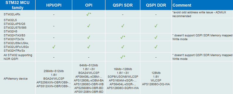

which memory PN are you looking for ?
Let me just remind that STM32H7B0 supports OPI (APS6408L)... and QSPI DDR (APS12808O-DQ) full spec but have a memory mapped write limitation for QSPI SDR (APS6404L...)
Thanks
Alex
PS: Overview of IoT RAM (QSPI, OPI  & HPI PSRAM) support
STM32 MCU familyHPI/OPIOPIQSPI SDRQSPI DDRComment
STM32L4Rx-✓*--*avoid odd address write issue - ADMUX recommended
STM32L5
STM32L4P5/Q5
STM32U575/585
STM32H5
STM32H7A3/B3
STM32H72x/3x
-✓** doesn't support QSPI SDR Memory mapped Write mode
STM32U59x/U5Ax, STM32U5Fx/U5Gx
STM32H7Rx/Sx
All STM32 supporting NOR QSPI--✓*-* doesn't support QSPI SDR Memory mapped Write mode

Hi @Alex - APMemory :
I want to use PSRAM with 3.3V, but I don't want to use BGA or WLCSP, it is too hard to weld.
STM32H7B0 won't support QSPI SDR (SOP8) memory mapped write, but fyi all following will :  STM32L5, STM32L4P5/Q5, STM32U575/585, STM32H5, STM32U59x/U5Ax, STM32U5Fx/U5Gx
STM32H7Rx/Sx
Alex
