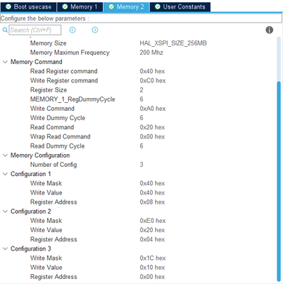

Struggling on PSRAM random errors, I found on APS256 datasheet default setting at 5 latency cycles (read/write) corresponding to 133MHz max.
I have modified EXTMEM_MANAGER config as
to set 7 latency cycles (200MHz max) and now deep-testing...
