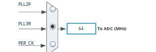

Based on this I understand the limitation only apply to final frequency fadc_ker_ck, and it is possible to use for exemple a system clock adc_sclk of 200 MHz, divide it by 4 via the Bits PRESC[3:0] of ADCx_CCR, and select it via the Bits CKMODE[1:0] of ADCx_CCR, since the clock is also
divided by two at the end, the fadc_ker_ck would be 25 MHz which is in the allowed range (< 50MHz)
Is my comprehension correct ? because when using the ioc configurator just to check this configuration it does not work if the source frequency adc_sclk or adc_ker_ck_input is above 50MHz, either the synchonous mode selection is grayed out or the clock is in red in the clock configurator (see attached captures)

It seems there is a limitation in the ioc editor for adc_sclk or adc_ker_ck_input, because if I use divider to set adc_sclk below 50 MHz, I am able to select synchonous mode selection, which is no longer grayed out in the adc clock source, and if i manually input 50 for the adc_ker_ck_input in the clock editor it is no more in error.
Actually I won't use the editor no more, and I want to use only HAL library, but I want to be sure to be able to use an adc_sclk source for ADC above 50 MHz but with the clock dividers the final fadc_ker_ck will be below 50 MHz
