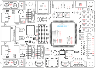

Unfortunately, I could not find non Chinese documentation, please find attached the datasheet of the board, and here are a few relevant schematics:
I am trying to the the pin on the top left corner (next to OUT EN PC14), and please note that U1 here is made of the SIT1042.

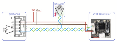

So I am able to send CAN messages and receive answers from the CAN USB device to the Stepper motor controller, from my understanding it indicates that the electronics setup (such as terminal resistor values) should be good.
Now, my issue is to have the STM32 based board use this CAN setup.
I have made a schematics of for the bus (I changed the DMMC02 connector but it is similar with CAN1).
mƎALLEm
May 26, 2025

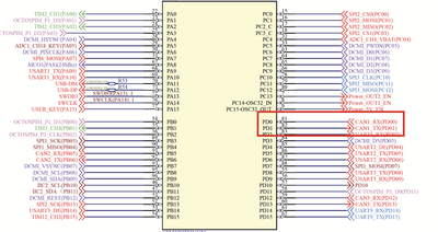

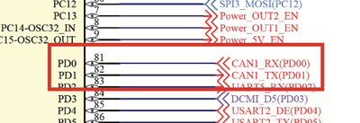

According to your ioc file, you mapped FDCAN1  on PA11 and PA12 while in the schematic, FDCAN1 is mapped on PD0 and PD1.
So please check this issue before going ahead: need to change FDCAN1 pinouts in the CubeMx.

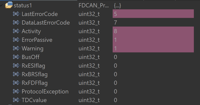

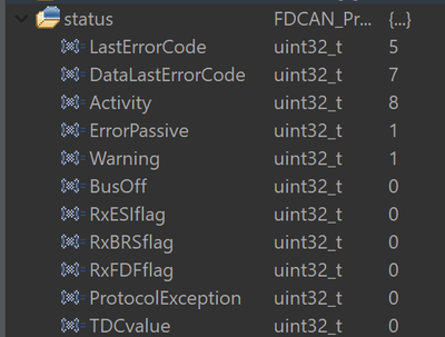

While I could not find a CAN monitoring software that allows peeking at the CAN error values compatible with the CANable CAN USB device, I was able to retrieve bus-related info directly using the HAL libraries.
I have applied the pin fix pointed out by mƎALLEm,and then changed my wait loop to this:
while(HAL_FDCAN_IsTxBufferMessagePending(&hfdcan1, FDCAN_TX_BUFFER0) == 1) {
		FDCAN_ProtocolStatusTypeDef status1;
		HAL_FDCAN_GetProtocolStatus(&hfdcan1, &status1);
	__NOP();
Since the pin fix, the program is not stuck in the while loop right away so there is definitely something going on, this is the state of status in the first iterations
(Note: "1 iteration" = "1 send attempt" =  HAL_FDCAN_AddMessageToTxBuffer + HAL_FDCAN_EnableTxBufferRequest + HAL_FDCAN_IsTxBufferMessagePending) :
LastErrorCode=5 : Bit 0 (dominant) error
DataLastErrorCode=7 : No change since last read
Activity=8 : Node is neither receiver nor transmitter
ErrorPassive=1 : Passive state
Warning=1 : at least one of error counters has reached the Error_Warning limit of 96
, and then after more iterations, the program gets stuck in the while loop waiting for transmission, here is the value of status
As you did anticipate, the setup seems to indeed fail to transmit and accumulate error, leading to error-passive and bus-off states. I also did confirm with a quick setup that when the STM32 is asked to send a CAN message, no signal can be seen on the bus.
[...] but a CAN message is not considerated sent until an ack from a receiving node is detected. I think there is no successful transmission at all from the STM32 side.
I understand that it seems that something is wrong, leading to the STM32 being unable to send any message. I did multiple checks of my wiring and I cannot find issues here.

In absence of specific tools, I would recommend to disconnect the working nodes (the USB-CAN device and the motor controller) from the bus and only connect a termination resistor. Then capture a transmission from the STM32 with a scope (or a logic analyzer which can be configured to the CAN levels). Compare the signal to that of a proper / working transmission.
Either the transceiver hardware on the STM board is the issue, or the CAN bus settings of the STM32 itself are not correct.
If that is possible, you can try to connect the STM32 CAN Tx/Rx pins directly to the respective CAN Tx/Rx pins of the motor controller, and see if that works.

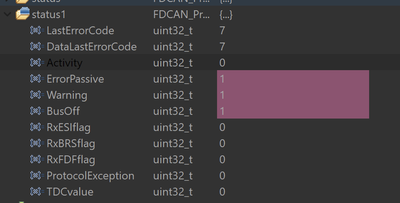

Here is an update narrowing down where the issue might be further.
I have followed the guide here https://controllerstech.com/stm32-fdcan-in-loopback-mode/ to make a simple FDCAN Loopback setup, and then I changed the configuration up to when it no longer works.
From my understanding, in external loopback mode, it should send signals on the bus (but no read from it) while it reads its own signal. While I can receive the signals on the STM32, there seem to be no signal on the bus.
The program still works unless I remove change from loopback mode to normal mode (I was able to successfully go form that guide's config to classical CAN, 8bit messages, extended can ID).
In external loopback, as expected, TxData is sent and RxData being filled with the content of received data.
When using normal mode, as before nothing happens. Here again, reading the status with HAL_FDCAN_GetProtocolStatus(&hfdcan1, &status1); gives:
with Activity=8 : Node is neither receiver nor transmitter.

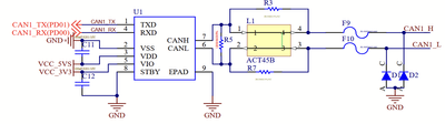

Another question,
In the datasheet the transceiver is an 8 pin package:
 while in the schematics the transceiver has the pin 9 called "EPAD":
.. not sure if this the same transceiver part number..
Ozone
Principal
May 27, 2025
This is usually a metallic & conductive connection to die bulk, often cooling fins. Sometimes simply the exposed die itself.
However, the standard version of this transceiver is 5V logic, as I understood it.
Only the xxx/3 version is 3.3V logic. I would at least check.

1. Thank to your suggestions, I found out that the CAN controller was indeed not being powered correctly. Resolving this lead to this new status struct values:
  • Last Error Code: 3 Acknowledge error
  • Activity: 24
  • Error Passive: 1
  • Warning: 1
