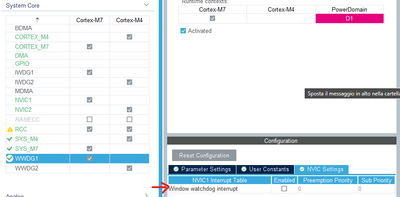

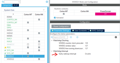

Regarding the two interrupt:
this one is the "normal" one, which is also reported in the NVIC1 section.
this is the EWI.
@AScha.3 , so these interrupts basically differ for 1 count, right?
But with the NVIC one reset has already been initiated, there are other functional differences?
If I just need to set a variable for WWDG detection (after reset), could I use this one.
Right.  But the early is just an INT , the "normal" is reset/restart.

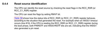

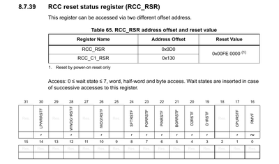

I would like to recognize the reset cause: after WWDG reset the system shall enter in error state; otherwise (power on reset or bootloader jump) it shall start normally.
It could be useful the trick to freeze the WWDG, but this is probably off-topic there...
Thanks again for your reply!
For this : see rm,  there is a extra register...
