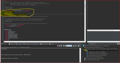

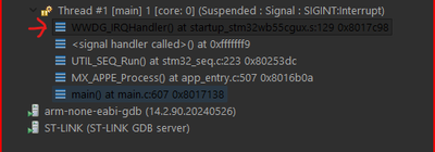

After configured the GPIO pins via STM32CudeMX and generated the code, when I run the firmware, the "WWDG_IRQHhandler()" problem keep appearing from no way and hinder me from the rest of the development. Please see the attached screen shoot picture. Even after I commented out the customize codes the problem didn't go away. Same problem seen on the P-NUCLEO-DONGLE too. I configured the MCU to support "USB HID + Zigbee".
Any help?

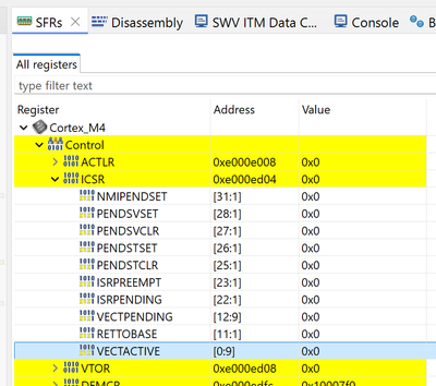

You can view them in the SCR tab when debugging:
Take the VECTACTIVE number, subtract 16 and compare it to the IRQn_Type so see what the active interrupt is.

This is probably the default IRQ handler, which means you've enabled an interrupt that you haven't implemented in the code. Perhaps it's misspelled.
Look at VECTACTIVE bits in SCB to find out which interrupt it's actually in.

Based on your earlier reply, I can't find SCB register in the datasheet. What is the full name of SCB?

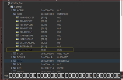

Thanks for the details guide. Below is the VECTACTIVE value from my board 0x3C (60).
After minus 16, I got 44 which is "IPCC_C1_RX_IRQn = 44" is it correct?
Then this "IPCC_C1_RX_IRQn" used by the function "void HW_IPCC_Init( void )".
From the CubeMX, when I select Zigbee, it requires IPCC enabled, so I'm lost now any suggestion what should I do next?
Phang
I manage to handle the IRQ by adding the handler codes. Thanks for the help.
