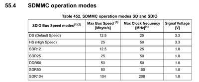

AScha.3
May 21, 2025
>My SD card actually supports a clock frequency up to 104 MHz
fine, but my H7 needs 1.8V transceiver for this - you have this ?
at 3v3 : 50M max ...
