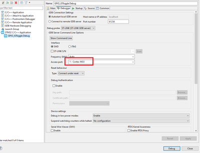

Just wondering why Access port is set to "Cortex-M3" while it needs to be "Cortex-M33"?
If you try any STM32CubeIDE project example from STM32H5 Cube package and go to Debug Configuration you get (from GPIO_IOToggle example):

That's a great question.  I looked at my colleagues Debug Configuration again and his is indeed set to 1 - CortexM33. The only option I have is 0 - CortexM3.  I imported the project using the .ioc file.  I went back and checked the project I built using the NUCLEO-H503RB and noticed that I had a second project open in STMCubeIDE and it was the one launching when I was trying to debug.  When I closed the other project I am indeed able to launch and debug the sample project.
So I think this gets me half way there.  Two open questions.
1. How do I change this to 1 - CortexM33 if the option is not available.
2. More importantly, how do I open and existing working project that is created on a colleagues computer and get the correct settings so I don't spend 5 hours trying to get the debugger to work in the future.

1. "How do I change this to 1 - CortexM33 if the option is not available."
-> I think there were an issue during the code generation. If CortexM33 option is not available for a generated code for H503 device it should be an issue during the code generation.

Your going to laugh because I'm crying here... I cloned the wrong project and it was for STM32F1 chip.  It was very similarly named.  Nothing to see here...
Jacob
I guess advice for someone looking at this thread in the future is make sure you have the right chip in your .ioc file in the "Project Manager" tab:
Or on the Pinout & Configuration Tab:
