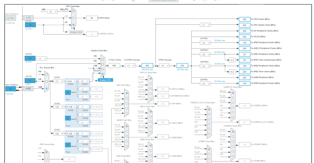

Hi friends.
I work with this chip STM32H753, but I set wrong clock.

And my program stay here:
while (LL_RCC_GetSysClkSource() != LL_RCC_SYS_CLKSOURCE_STATUS_PLL1)
Any idea, what is wrong?

Check the content of relevant registers. Output PLL to MCO and observe. Do you set FLASH latency appropriately to the clock? Is voltage regulator set appropriately?

‎2019-08-13 1:28 AM
Here is my function code for clock. :)
