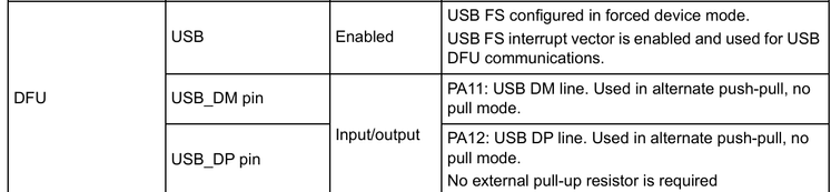

Primary test BL DFU with boot pin setup and are you sure USB on DK is
I was able to get into DFU with the USB by using CubeMX to configure the USB port as DFU. However, I would like to generally use the USB pins as VCP and then have the option to boot into the bootloader to get the USB to connect in DFU Mode. This way I could have both.
I am confident that the USB should work in this manner because I was able to do it if it was configured as such (if I am understanding your question correctly).
No you missunderstand. Normal way use internal bootloader is HW BOOT0 pin setup on HW reset. When this work for you ( show device in windows devices list and connect in CubeProgrammer.)  , continue with try call from your code. And connector USB for this is CN13 only on DK.
Okay, I think I understand what you are saying. I used STM32Programmer to change the boot address to 0x1FF09800with BOOT0 pin setup. I am able to connect by doing DFU so something else is incorrect here I guess.
What should I do now?
