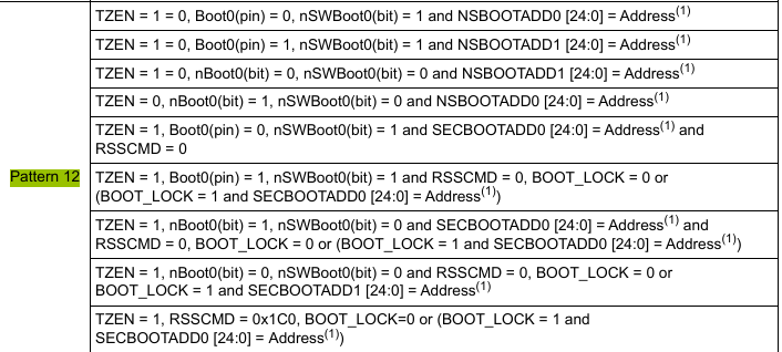

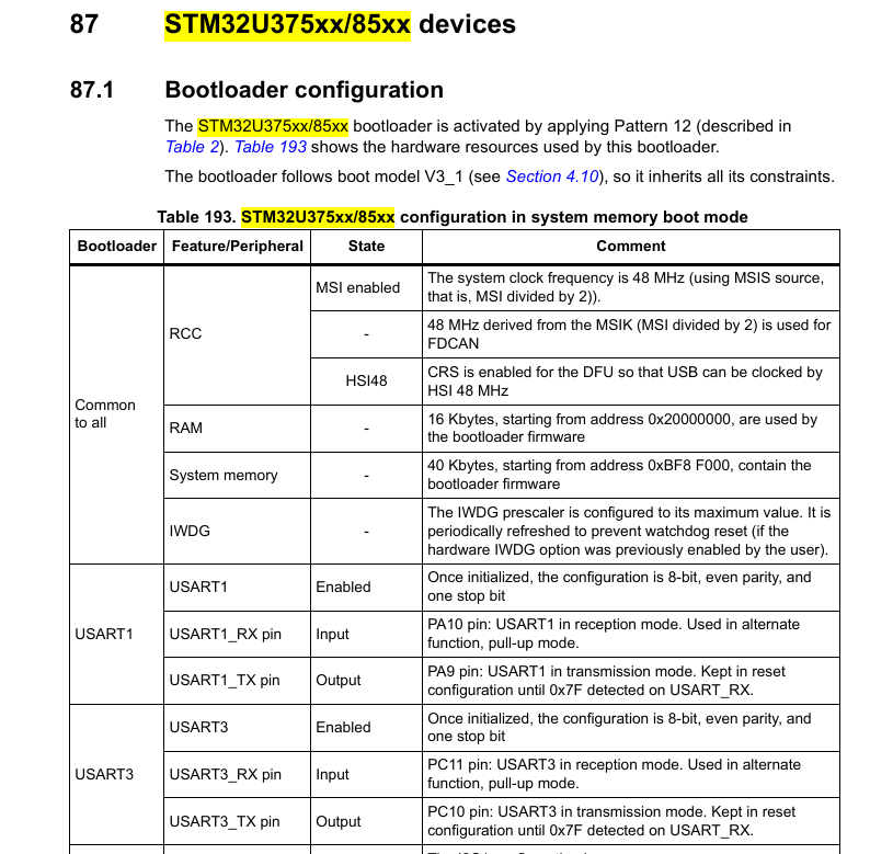

usart.PNGpattern 12.PNGHello @mƎALLEm,
Thank you for your response.
I read the AN2606 document, which explains the USART configuration and the bootloader settings.
Normally, to flash a .hex or .bin file, we need to boot from the System Memory using the BOOT pins. However, I want to boot(system boot) my ST controller using from my application code, without using the hardware BOOT pins. In other words, I want to trigger the bootloader by software instead of configuring the BOOT pins physically.
