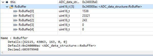

Hi everyone, hope all of you are doing well.
Posting here again about the ADC. I finally got the ADC out of that over run situation and now ready to acquire data!
The way the ADC is setup is by having 4 channels using Pins setup as continuous scanning
PC2 = Channel 0 for ADC 3 Rank 0
PC3 = Channel 1 for ADC 3 Rank 1
PF9 = Channel 2 for ADC 3 Rank 2
PF7 = Channel 3 for ADC 3 Rank 3
and internal temperature sensor = Channel 12 for ADC 3
I am essentially polling for the DMA1 Stream 4 Transfer Complete 4 flag, once this is done I know that the ADC has done all 5 sequential reads, however when I get into the array or even the data there's either nonsense data or zeros. The channels that read zero I have tried hooking up those pins to VDD and it still reads zero. I notice in the ADC3->DR there's a lot of activity going.
What I have tried thus far is, changing DMA to one shot mode, behavior is the same.
I am not sure what's going as it seems to look like the DMA is not transferring from ADC3->DR properly into its memory buffer. The buffer being used is in the x2400 region of memory and there's no error flag set for either DMA1 or ADC3.

Data within the buffer once Transfer Completed flag 4 from the DMA1 is triggered. Just pure nonsense data. The pins are pull down and not in used but here there's some kind of voltage.

data seen in buffer, this shows ADC_DR => buffer should work. it is suggested to simplify the project, for example, to convert one channel only per time. for LL_ADC_CHANNEL_TEMPSENSOR, I see 625~630mV at room temperature. for LL_ADC_CHANNEL_VREFINT, I see 1221~1224mV.
Yup, just converted the ADC3 to a 1 channel scan with the temperature sensor enabled only. I am seeing now 0.0076539251V on the channel
equation used (ADC->DR)/(2^16-1/3.3). Is this normal operation?
@jiangfan​ Figured out the issue but not the solution yet. Its the DMA transferring the data. I see the data within the ADC-DR register correctly however when the data is transferred in to the array buffer its completely different.
For example ADC3->DR = 0x30B0, and in Buffer = 0xA5. No idea whats going on here
if you worry about the issue during DMA transfer, you may have a look at ADC DMA example, for example, STM32Cube_FW_H7_V1.9.0 -> Projects\NUCLEO-H743ZI\Examples\ADC\ADC_DMA_Transfer. compare the difference.

Thanks to you I found the error.
Problem line:
ADC_Config_DMA.PeriphOrM2MSrcDataSize = LL_DMA_MDATAALIGN_HALFWORD;
Fix:
ADC_Config_DMA.PeriphOrM2MSrcDataSize = LL_DMA_PDATAALIGN_HALFWORD;
