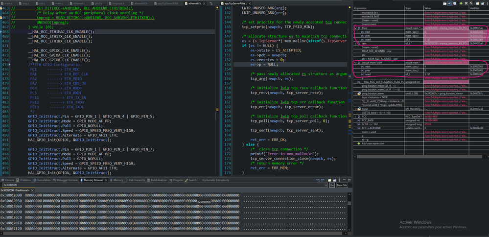

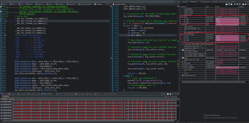

I'm having issues with the Heap of the LWIP that is used/full, and I can't do any mem_malloc.
I have dig a bit on why the log of LWIP tells me that  it couldn't allocate memory ("etharp_raw: could not allocate pbuf for ARP request"). As far as i understand, the mem_malloc used the struct mem *lfree variable to handle the allocation for the LWIP and which is the next/previous chuck and also if the next chunk is being used or not.
struct mem {
 /** index (-> ram[next]) of the next struct */
 mem_size_t next;
 /** index (-> ram[prev]) of the previous struct */
 mem_size_t prev;
 /** 1: this area is used; 0: this area is unused */
 u8_t used;
#if MEM_OVERFLOW_CHECK
 /** this keeps track of the user allocation size for guard checks */
 mem_size_t user_size;
#endif
My issue is that the variable used in the mem struct is never null or zero. Which lead to the mem_malloc to always return NULL even after a fresh upload or power up.

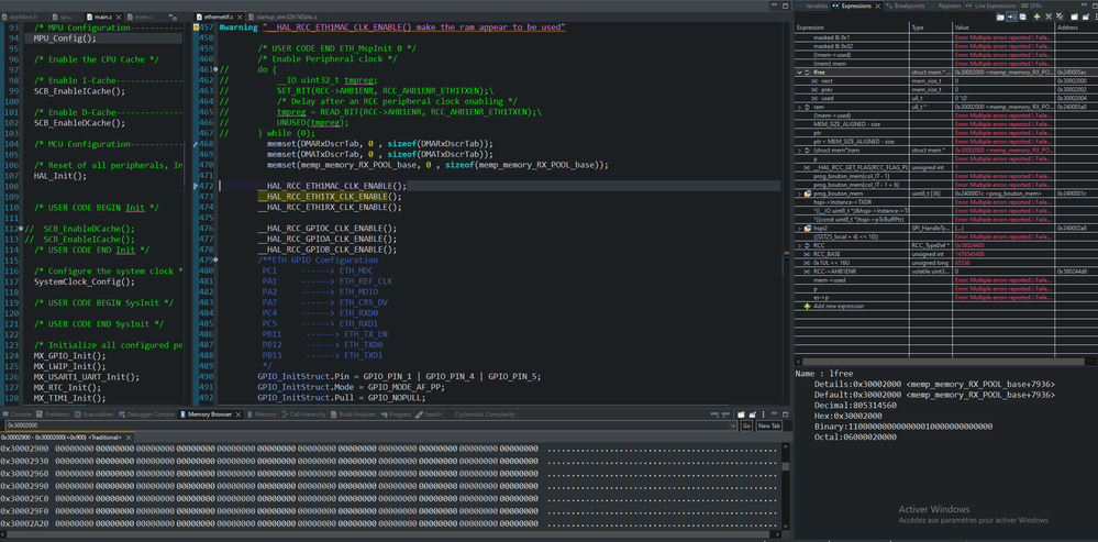

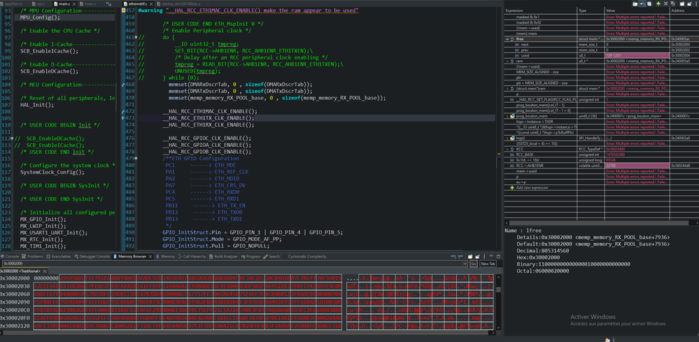

I manage to track down what appear to be written in the memory area dedicated for the LWIP heap. It occurs in the HAL_ETH_MspInit ("void HAL_ETH_MspInit(ETH_HandleTypeDef* ethHandle)") with the line "__HAL_RCC_ETH1MAC_CLK_ENABLE();"  as you can see in the picture
FAV_Before-__HAL_RCC_ETH1MAC_CLK_ENABLE.PNGFAV_Before-__HAL_RCC_ETH1MAC_CLK_ENABLE.PNG
> FAV_After-__HAL_RCC_ETH1MAC_CLK_ENABLE.PNGFAV_After-__HAL_RCC_ETH1MAC_CLK_ENABLE.PNGFAV_After-__HAL_RCC_ETH1MAC_CLK_ENABLE.PNG
Before the call, the ram is zero, after the call the ram is full.  You can also see in the Expressions panel on the right that before the call, lfree is empty, and after the call lfree is not empty anymore and point to some random chunk.

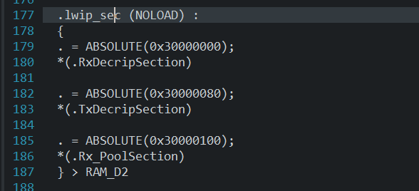

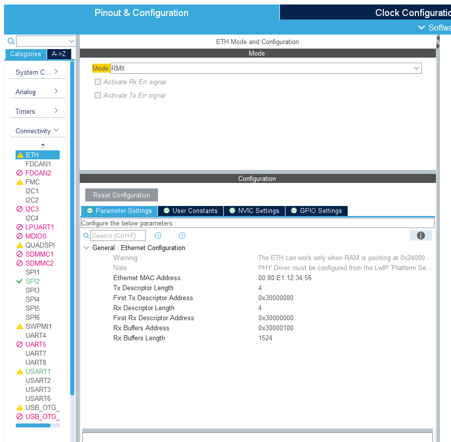

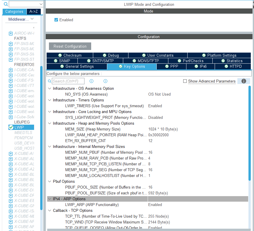

I'm providing you the ETH_ICO config, the LWIP_ICO config, and the change i made in the FLASH.ld
For the LWIP and ETH configuration in the ICO, I have follow this guide/serie :

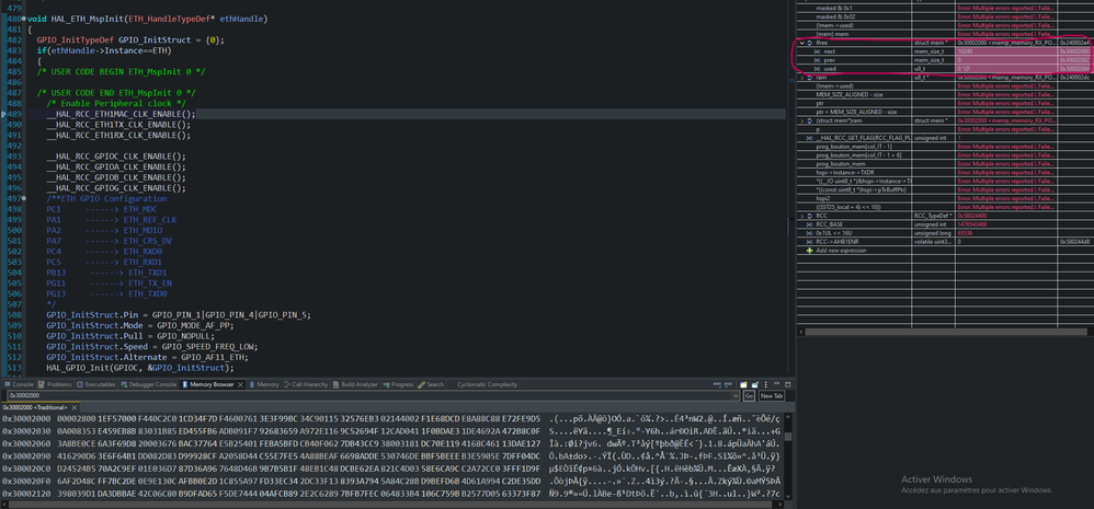

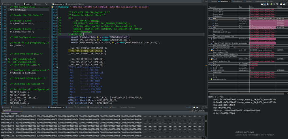

Sure, here is the picture before the memset of the three arena declar in the flash.ld :
FAV_BEFORE-__HAL_RCC_ETH1MAC_And_Before_memset.PNGFAV_BEFORE-__HAL_RCC_ETH1MAC_And_Before_memset.PNG
After the memset but before the "__HAL_RCC_ETH1MAC_CLK_ENABLE()" :
FAV_BEFORE-__HAL_RCC_ETH1MAC_And_After_memset.PNGFAV_BEFORE-__HAL_RCC_ETH1MAC_And_After_memset.PNG
Here is after the memset and after the "__HAL_RCC_ETH1MAC_CLK_ENABLE()" :
FAV_AFTER-__HAL_RCC_ETH1MAC_And_After_memset.PNGFAV_AFTER-__HAL_RCC_ETH1MAC_And_After_memset.PNG
There might be a better way to zero those arena with the ld file but I don't how to.

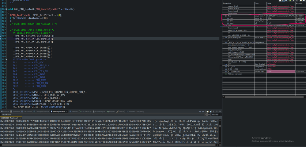

Explorer
Feb 5, 2026 9:27 PM UTC
I have the same issue on NUCLEO-H743ZI2 board.
Before calling __HAL_RCC_ETH1MAC_CLK_ENABLE(); macro in HAL_ETH_MspInit() function, all LWIP heap area is zero. After calling this macro, LWIP heap area is corrupted.
Before calling the  __HAL_RCC_ETH1MAC_CLK_ENABLE();
After calling the  __HAL_RCC_ETH1MAC_CLK_ENABLE();
