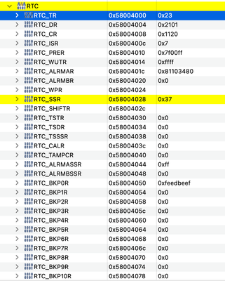

I'm working on a custom board using an STM32H743IIT6. In general, the board is working, but I'm running into an issue with the RTC. The RTC is running accurately, but when I reset the board, the RTC resets. This happens even if I just terminate and restart the connected debugger, without disconnecting power. I've read through about 20 pages of RTC related posts here, and have checked all sorts of things:

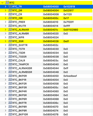

I tried setting a watchpoint on RTC_TR and it doesn't trigger on reset, it triggers only when I set the clock through my UI.
Here are the registers after I set the time & date, and then immediately after resetting (first line of SystemInit()):
2025-09-17 11:35 AM
I was using the debugger to reset just so I could monitor the registers. Also, it would bypass my bootloader, in order to eliminate that variable. However, just power cycling the device results in the same outcome (the clock resets, backup registers do not).

As is often the case, it turned out to be my fault. I didn't realize that my bootloader had that Cube generated RTC boilerplate code that resets the date and time every time. This explains why power cycling the unit would reset the clock.
The debugger case is a little weirder. The bootloader wasn't supposed to run when I ran the code through the debugger, the entry point is different. Nonetheless, it seems to be retaining the time and date in debugger as well, so I'll call it solved for now.
