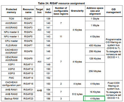

First off, Backup RAM is 8 KB, but RISAF area for that is 4 KB:
When defining full 8 KB Backup RAM area in CubeMX MMT and let it automatically do RISAF configuration and generate SystemIsolation_Config, then that will fail in assert because RISAF23_LIMIT_ADDRESS_SPACE_SIZE is 4KB (minus 1) not 8 KB (minus 1). Assert is valid based on RM table 24, but tool creates bad code.
Okay, so I used first 4 KB.
I tried simply writing to Backup RAM and reading it back. It reads zeroes. So write is not effective. I enabled all the clocks and accesses and all kind of modes like you have in the code above. Tried with and without cache. Thing that made it work was not configuring RISAF23 region (and skipping system isolation completely). I tried playing with secure and privilege attributes also, didn't help. Other RAMs have same attributes and work without issus.

I have MPU configured (by MMT) over Backup RAM area and it is made non-cacheable with attributes. Unfortunately this doesn't seem to have effect, because only when I added manual cache flush (clean) and invalidate operations, it started working like expected.
