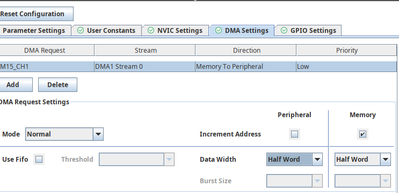

I use TIM15 and DMA1, channel 5 in STM32H743. If DMA and data have a size of 32-bit, then everything works fine. If you configure DMA on 16-bit data, then 32-bit data is still written to the TIM5 registers.

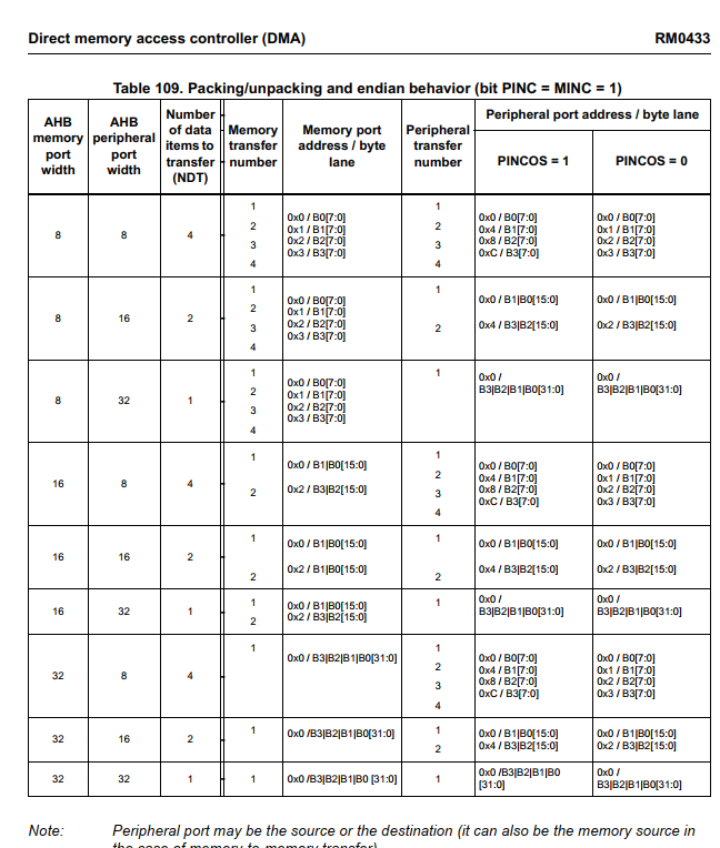

This won't work and you cannot save memory, the data for TIM5 have to be 32-bit.
DMA1 is a dual-port DMA (i.e. the same as in'F2/'F4/'F7), and does not zero-extend the data. It means, that if you set it to 16-bit at the memory side and 32-bit at peripheral side, it will assemble (concatenate) two halfwords from memory to a word tp output to the timer. If you set 16-bit at both memory and peripheral side, it will indeed write only 16 bits onto the AHB bus towards TIM5, but the AHB/APB bridge will copy the lower 16 bits to the upper 16 bits and both halves will be written to the timer.

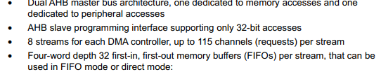

 Thanks for the reply. You are right. When I write a 16-bit value to TIM15 using DMA1 in HalfWord mode, a 32-bit value consisting of two 16-bit values ​​is written to the register. While studying the manual, I found a note that says the AHB bus only works in 32-bit format.
 The user manual explains that DMA1 can't write, for example, 8-bit data to 32-bit registers. It won't pad the high-order bits with zeros. This means I can't save memory and will have to store all data in 32-bit format.
The BDMA module can pad the high-order bits with zeros. However, this module can't send data to the TIM15 because it uses the DMAMUX2, which doesn't have a TIM15 channel.
This is not related to your problem. This says, that DMA's registers can't be accessed in other than 32-bit way, i.e. the processor has to write DMA's registers only using instructions with 32 bit data; this does not say, how DMA accesses other peripherals.

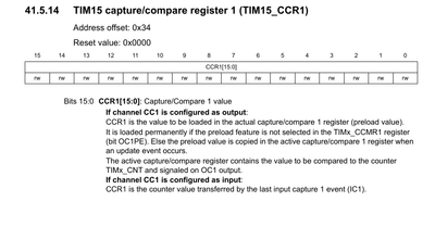

Thanks for the reply. I'm working with TIM15. I'm writing three register values ​​(ARR, RCR, CCR1) to the DMAR register.

Thanks for your help. I figured out the problem. The peripheral register size was incorrectly specified (32 bits instead of 16 bits) and the RCR register value for timer 15 was incorrect.
